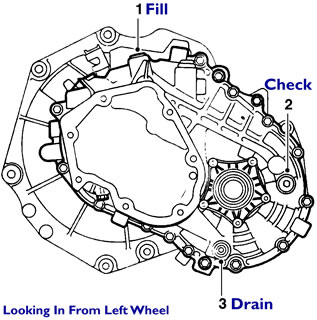

Procedure
1. Drain the oil from the gearbox by unscrewing the drain plug (3).
2. Fill with 1.0 litre (1.05 quarts) of the new oil (plug 1) and run the car so that the oil flows thoroughly through the system.
3. Drain the gearbox (plug 3).
4. Fill the gearbox with new oil to the correct level (1.8 litres; 1.9 quarts). Check with the level plug (2).
After this procedure, the oil does not need changing.
5. Fit a new filler plug (1).
6. There are two labels on the neck of the oil carton that must be affixed to separate places as a reminder of the type of oil in the gearbox.
7. Clean the area around the radiator crossmember by the left-hand headlamp, remove the label with the warning triangle and affix it to the radiator crossmember.
8. Remove the small label and affix it over the existing text on gearbox oil in the owner’s manual under the section “Technical data”.
