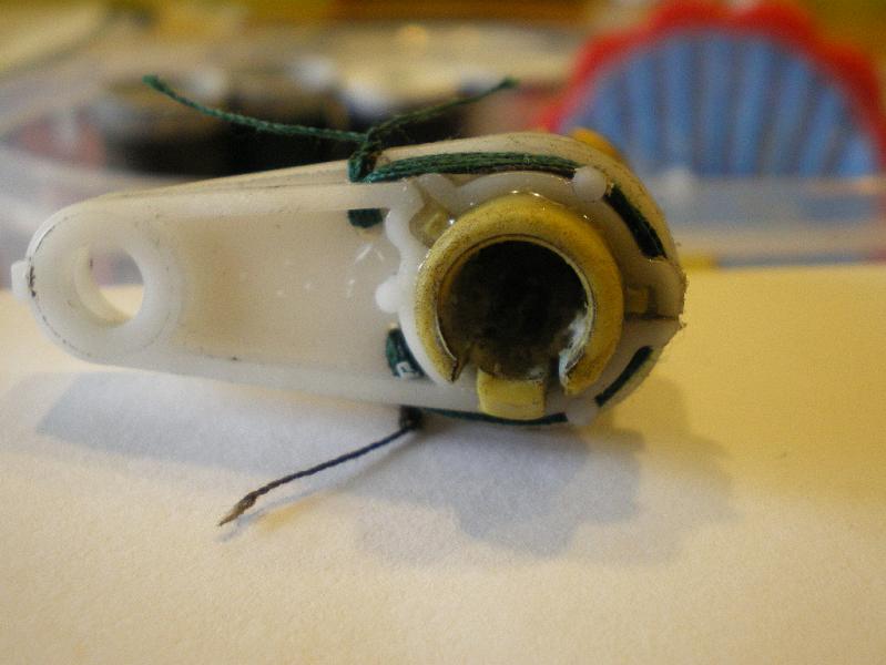

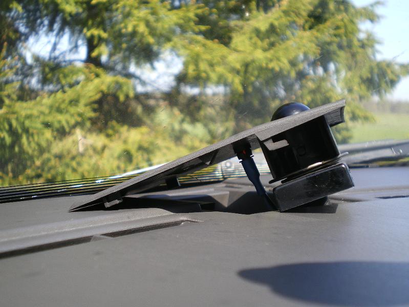

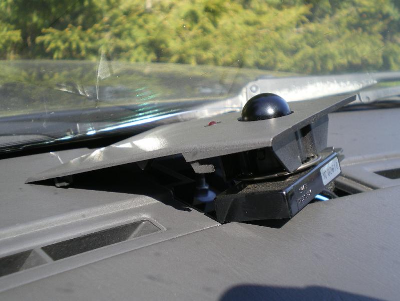

Vana stoppvarrele puurisin sisse avad ning viilisin kohad, kust saaks niidiga tugevduse läbi punuda, siis liimisin vana stopvarre völlile tagasi, 3 tundi kuivamisaega:
http://photo.platonoff.com/Auto/2009101 ... or_Repair/
Saab 9-5 Estate 2.3t -->3.0t, 1999, overspeed
Postitatud: K Mai 04, 2011 19:20
Postitas overspeed
Mitmekordne tugev niit peaks olema piisav tugevdus tulevikutarvis, sest kogu niidistik sai EPO taolise liimiga üle määritud.
Eks näis kuda önnestus, pole paika veel saanud panna, sest liim kuivab alles.

Peale detaili paika panemist siis testimiseks AUTO+OFF nuppe ning vigu ... 0
Oli vast "löbus" tööasend:

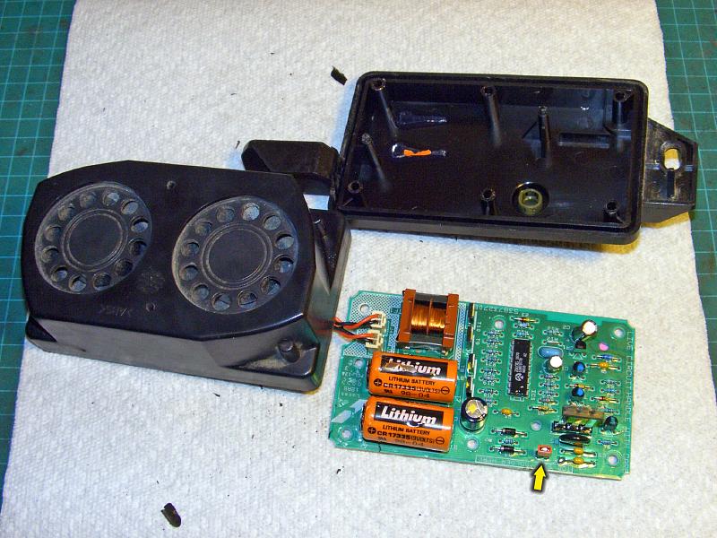

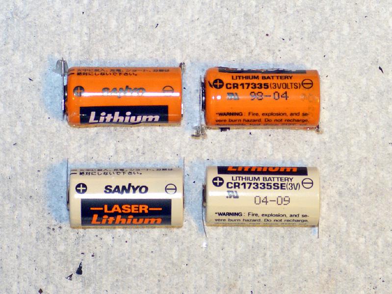

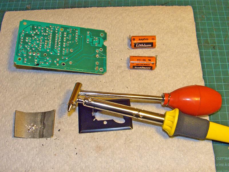

Kasutatud pasun uute akudega:
Akud tellisin sellised (pole küll samad/öiged, kuid alarmi SID ekraanil vötavad ära):
https://www.elfa.se/elfa3~ee_et/elfa/in ... &toc=18964

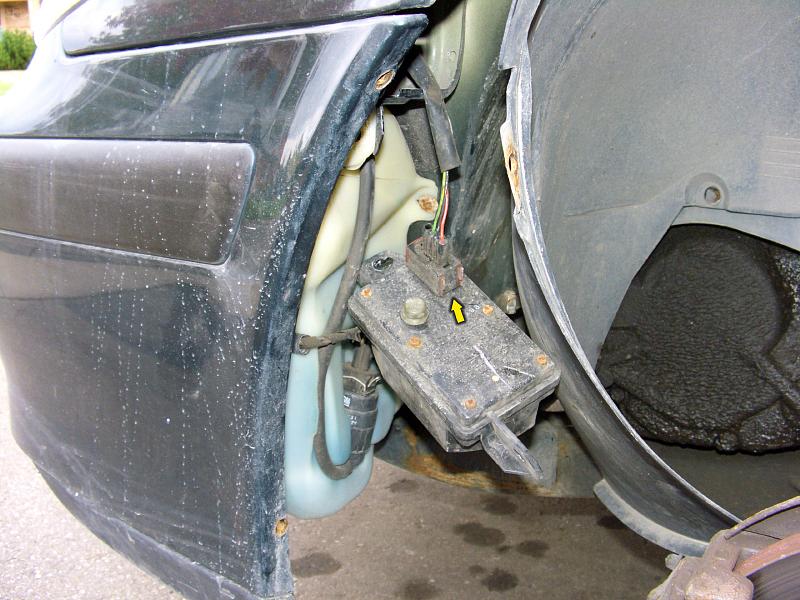

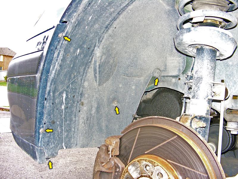

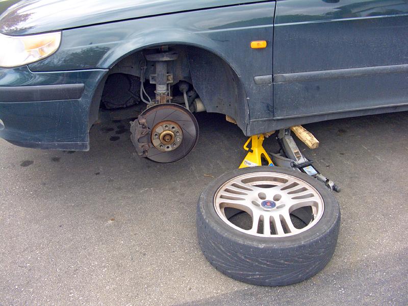

Wheel off
Raise the left front corner of the car and secure it on jack stands. Take the wheel off:

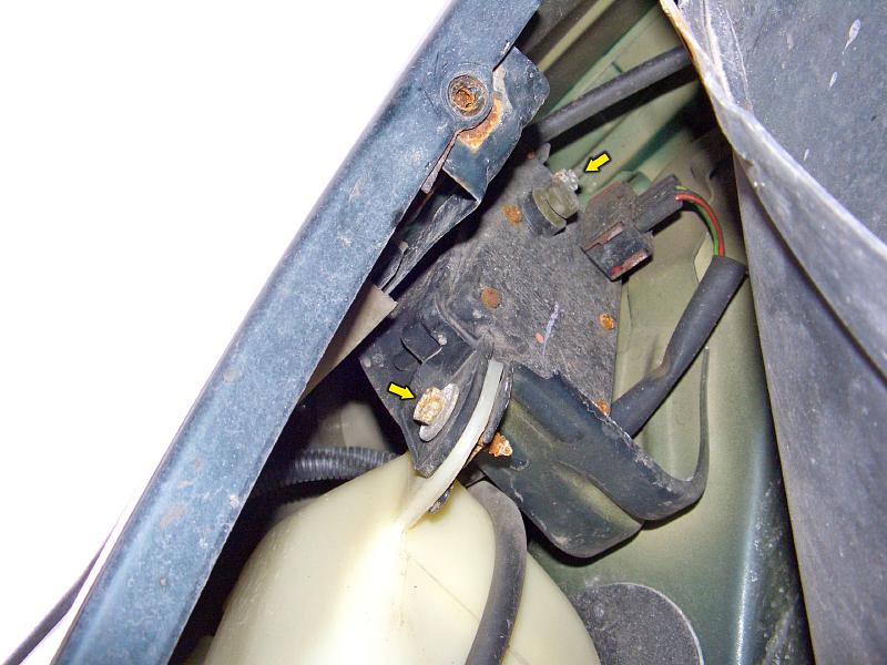

Lining
Undo the screws on the wheel well lining. There are two Torx screws along the bumper edge, two 8 mm on the inside, and one 10 mm under the lower lip:

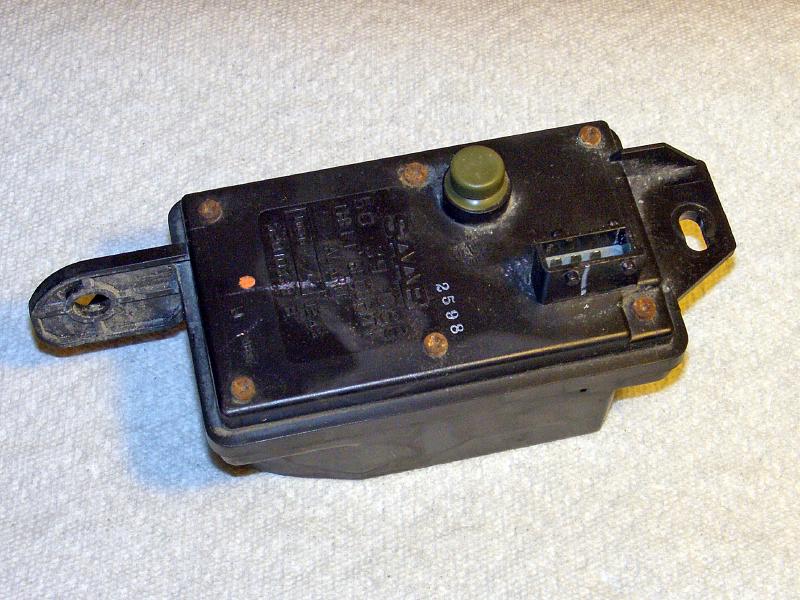

Nuts
Bend the lining away and unbolt the alarm module located right next to the washer fluid tank. There's a 10 mm nut at the top and a screw at the bottom:
Connector
Unplug the connector from the module. Make sure the car is unlocked at this point, otherwise the alarm will go off if theft protection was active:

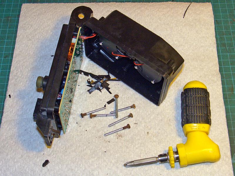

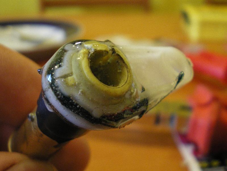

Module
The two halves of the module are held together by six Phillips screws:
Open
The cover is glued on with rubbery sealant, so you might need a knife or a flat screwdriver to crack it open:
Board
Detach the board carefully - the batteries are glued to the bottom cover, so you will need to pry them off. Pull the red jumper to cut the power from the circuits:
Desoldering
Desolder the old batteries. Be careful not to apply too much heat. Do not solder the batteries directly. Instead, detach their leads from the board:
Batteries
The old pair of batteries (orange) next to a new set (beige). It looks like the batteries are good for about 5 years, accordings to the markings:

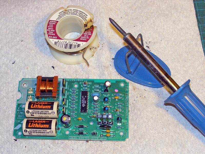

Soldering
Solder the new batteries on, follow the polarity marked on the board. Fit the jumper, assemble the module and re-install in reverse order:

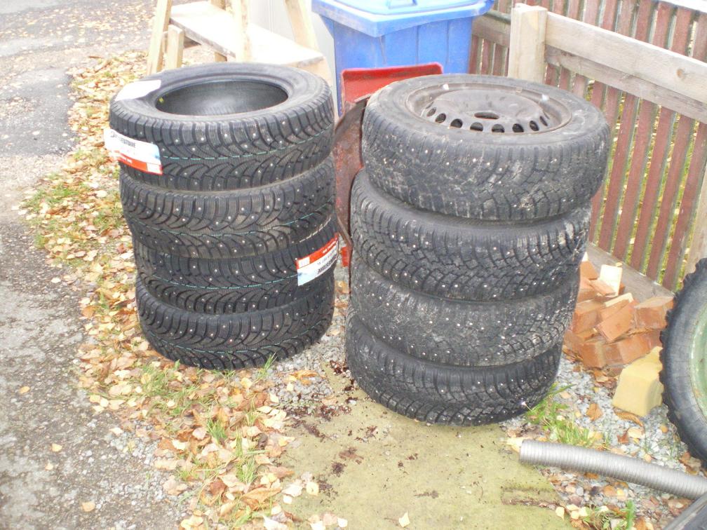

Valmistume talveks:
Postitatud: N Nov 03, 2011 22:50
Postitas overspeed
Viimasel reisil Pärnu poolt tulles "ei pidanud üks suverehv enam vasta". Sellel autol oli see SPARE nüüd kindlasti esimest korda all, tuliuus asi sai pagassist välja vöetud.

Postitas overspeed
Talveks siis teine jooks plekkvelgesid koos ilukilpidega:
