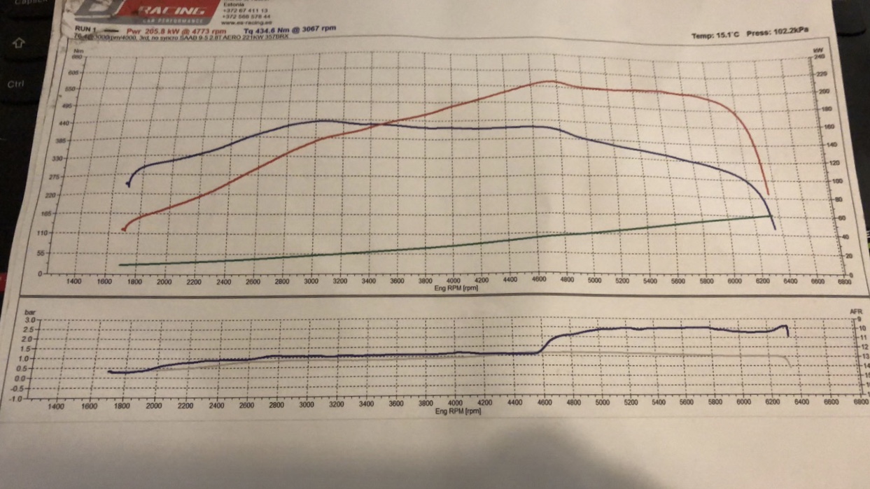

Hello, havent updated for a while, only problems appearing as usual
Had the car to ESracing (very good service here by the way) yesterday to get a quote for custom Exhaust, and to put the car on the dyno just to see how all Running. Unfortunately car was down on power, although torque was fine.
Graph 206kw and 434NM at 1.1 bar - issue seems to be caused by a huge AFR spike, dunno why yet, but will start with basics explained below.
Video
https://www.youtube.com/watch?v=gxyztlIjUZI
Also got the quote for the custom Exhaust, but while in the air, alas guys found a new problem of power steering leaking again, which i can add to the list of broken rear window motor, and power seat which has stopped working (hopefully just a fuse)
So to try and fix the power issue, I have ordered a new MAF today, a new purge valve, and new PVC pipes. Also one shop has checked the power steering issue, and its just some seals so that will be fixed tomorrow. Window motor had to be ordered so that will be done next week.
Anyway, fun times, lots of cost as usual. Once i get this power issues fixed then will get the exhaust done and hopefully a new remap, and all will be well in the world again.
Video

New MAF installed today, that made a huge difference actually
