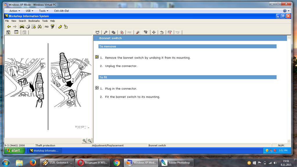

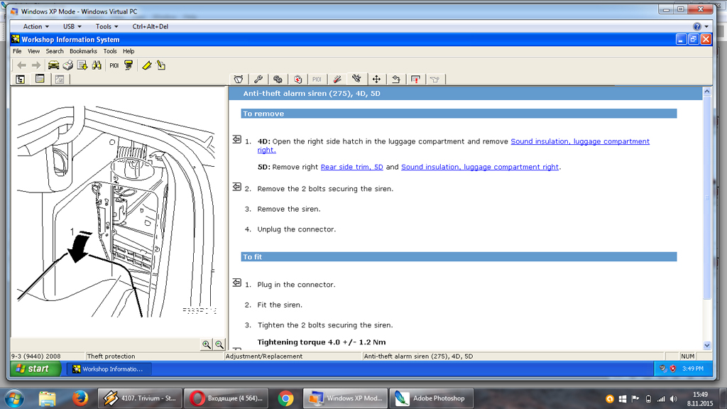

P Nov 08, 2015 16:30
võib olla sellest ka abi

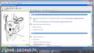

näiteks
http://www.ebay.co.uk/itm/SAAB-93-9-3-9440-03-12MY-ANTI-THEFT-ALARM-SIREN-12762811-12785181-USED-SUFFOLK-/331698215556?hash=item4d3ac11a84:g:l58AAOSwu4BVwHmC
http://www.ebay.co.uk/itm/SAAB-9-3-93-FACELIFT-2008-ANTI-THEFT-ALARM-SIREN-12-762-811-12762811-/111786571347?hash=item1a06ffb653:g:vJ4AAOSwNgxWDXCf
aga ei tea, kui suur vahe klambritel on masintel enne ja pärast facelifti
lüliti
http://www.ebay.co.uk/itm/SAAB-9-3-93-03-11-BONNET-ALARM-PIN-SWITCH-90-355-463-90355463-/111817831305?hash=item1a08dcb389:g:7dUAAOSw9r1WBB3E
