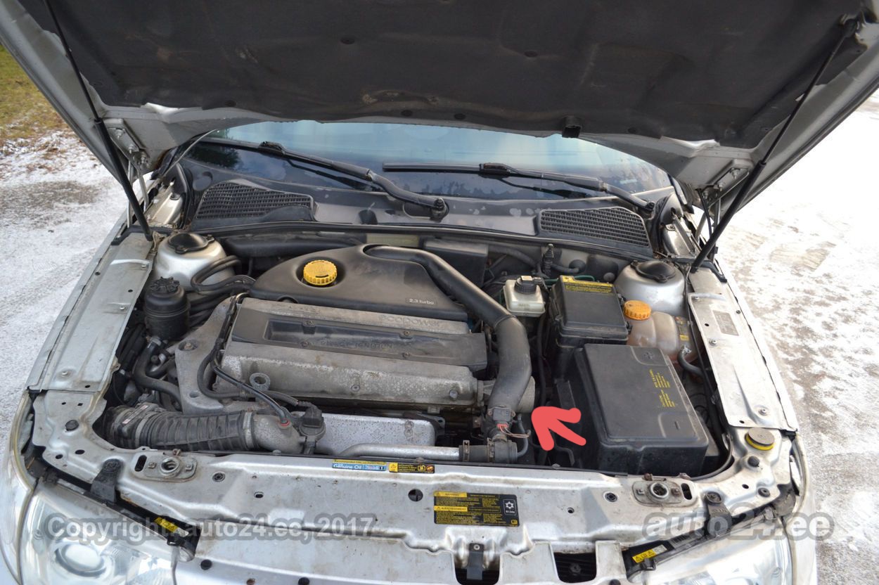

9-5 2,3 184kw mida teeb see asi?
Postitatud: L Veebr 06, 2021 19:27
Postitas Kaarelkaru32
Küsiks mis see on?
Re: 9-5 2,3 184kw mida teeb see asi?
Postitatud: L Veebr 06, 2021 20:13
Postitas Teretali
See metallist? Vaakumpump.
To increase the braking effect on Saab 9-5 2.0 and 2.3 with automatic transmission, these cars have been equipped with an additional vacuum pump. The pump provides the brake servo with negative pressure when the engine is unable to supply this fully.
The pump is ring type, mounted on the cylinder head and driven by the camshaft. Since it is connected to the camshaft, the speed of the pump is half that of the engine, and negative pressure is produced continually for the brake system.
Postitatud: L Veebr 06, 2021 20:30
See siis ainult automaatidel?
Postitatud: L Veebr 06, 2021 20:43
Postitas saabu14jr
Kaarelkaru32 kirjutas: L Veebr 06, 2021 20:30 See siis ainult automaatidel?
Just nii.
