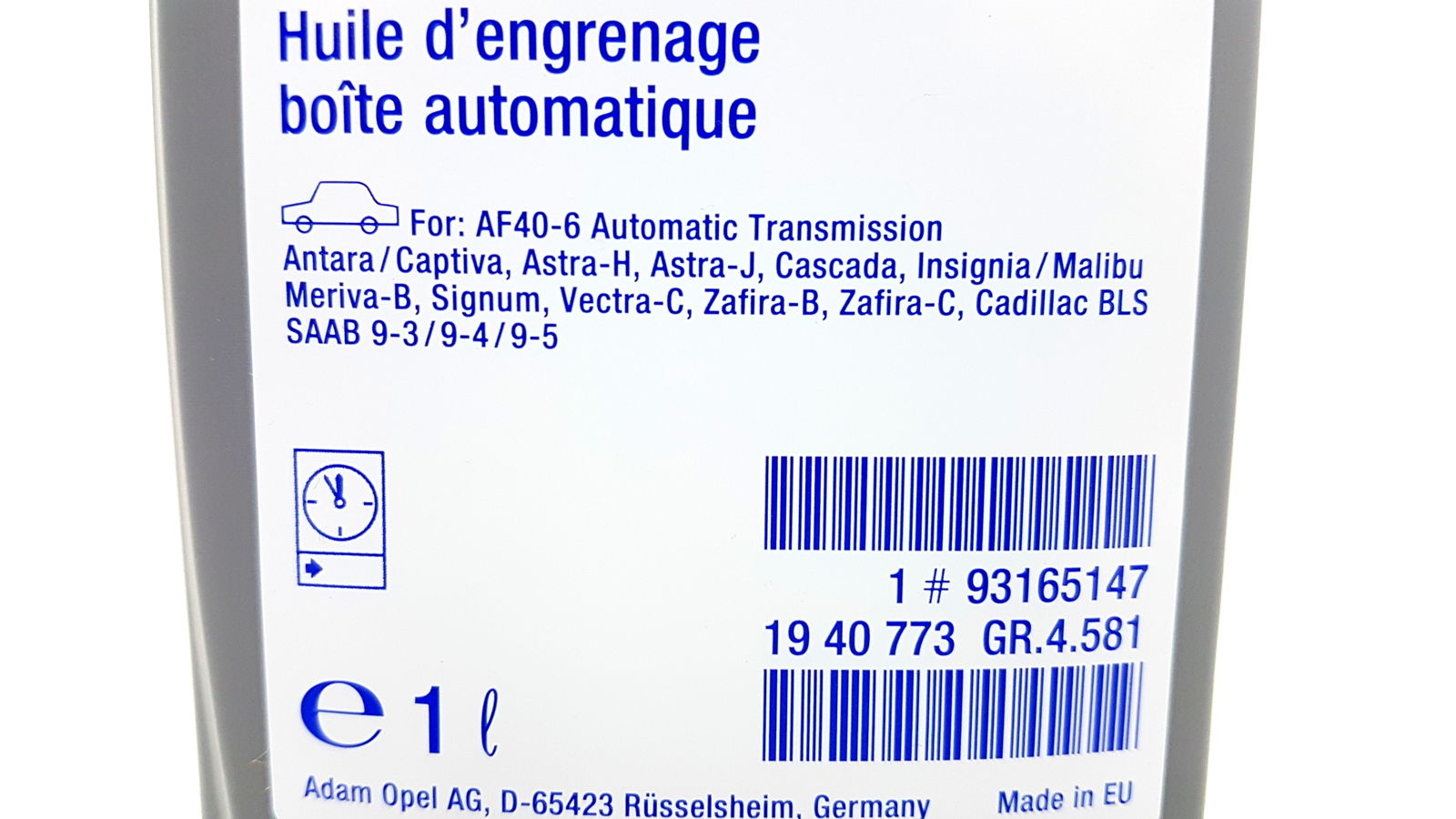

Fluid grade is Saab 3309 mineral oil based. Synthetic oil has a different coefficient of friction and should not be used.
Võib uskuda ja võib ka mitte.

Väidetavalt on ka see õli mineraal http://oilshop.ee/kaigukastioli-mobil-atf-3309-1l-689
