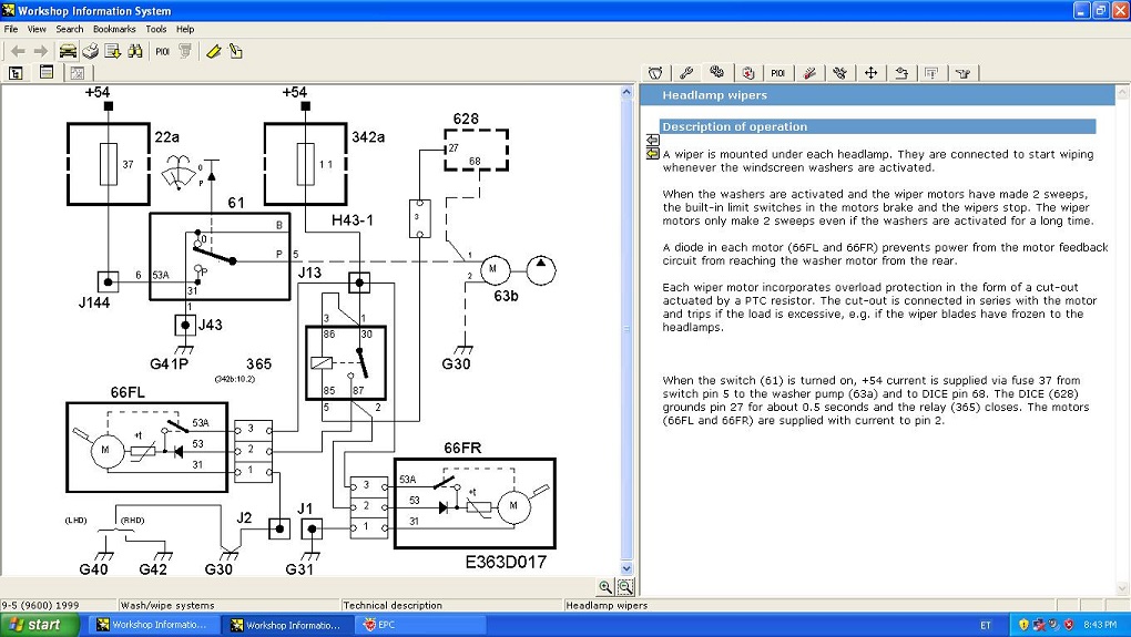

kui mõtled seda musta tabletikest, siis see peaks olema termokaitse. Ei ole väga hea idee vahelt välja võtta seda.
Seda ma löpuks temast kahtlustama jäin, et kaitseb näiteks kui kinni külmunud kojamehed talvel. Kuigi jättis mulje nagu oleks plaat-kondensaator.
Nii on. Külmumise korral on too "tablett" abiks, PTC resistor (Positive Temperature Coefficient). Soojenedes suureneb takistus ja kui maha jahtub, siis väheneb taas.
Esilaternate/esilampide kojameeste töötamise kirjeldus:
Viimati muutis overspeed, L Dets 16, 2017 16:19, muudetud 1 kord kokku.

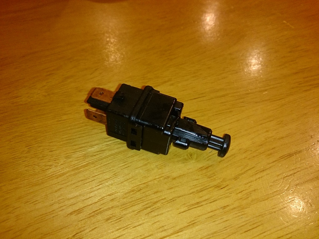

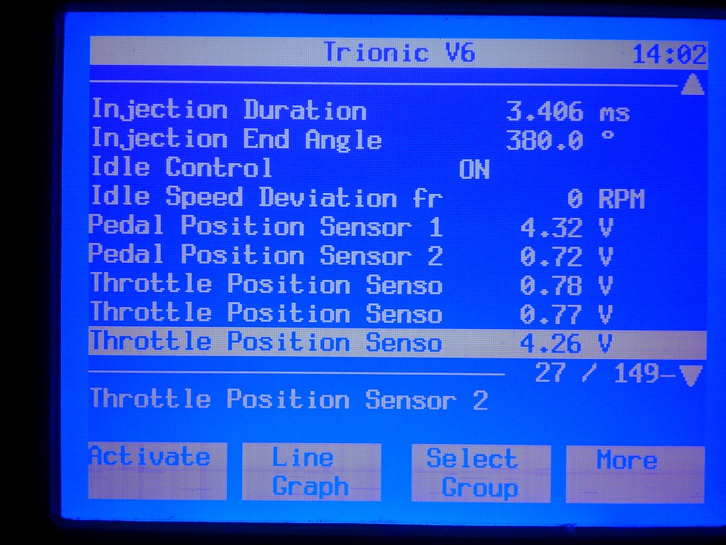

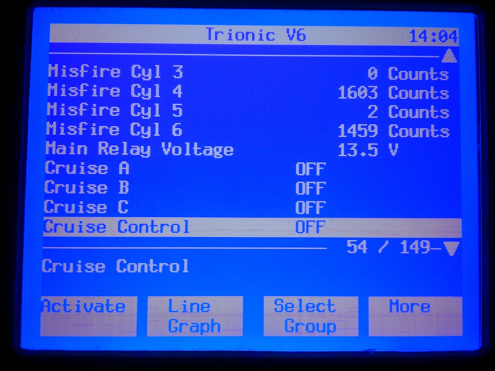

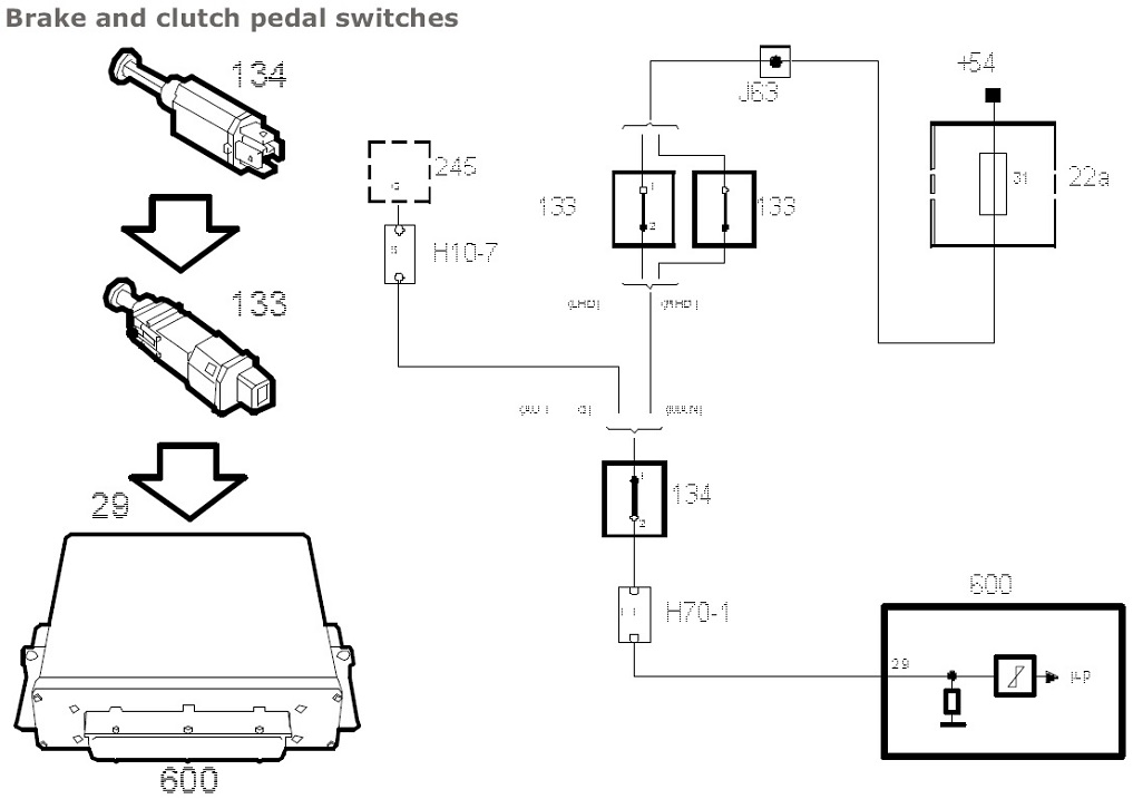

Piduripedaali all peaks lüliti olema. Äkki see jamab?
Kas cruisei jaoks on eraldi lüliti vöi saab cruise oma impulsi piduritulede lülitist ?
Kui esimene versioon, siis uurin sealt seda. Kui teine, siis peaks pidurituled ka pölema ajal, mil cruise ei tööta ... seda aga ta ei tee.

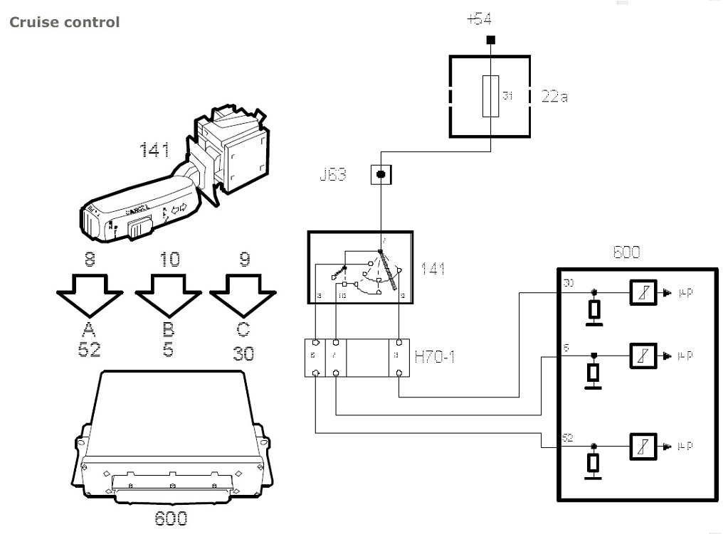

Väheke lugemist ka lisaks Cruise Control / püsikiirushoidja kohta manualist ja vastused saadud. Tänud Cyber'ile tähelepanu suunamise eest! :
Cruise Control
The cruise control is operated by the switch in the direction indicator stalk. The switch is supplied with current by the +54 circuit and has three outputs to the control module.
When the switch is turned to "ON", the control module sends the information "CRUISE lamp ON" out on the bus. The main instrument unit then turns on the lamp.
When the "SET" button is subsequently pressed, the control module stores the current speed in the memory, provided that the other conditions for the cruise control function are fulfilled.
The control module then reads from a table which gives the normal rolling resistance on level ground at different speeds. The requested (stored) speed has now been converted to a requested driving wheel torque.
The requested driving wheel torque is then compared with the gear engaged and converted into the requested engine torque.
The requested engine torque is converted to the requested mass air flow/combustion and comprises the input signal from the cruise control system to the mass air flow control system.
If the speed of the vehicle is lower than that requested, the requested mass air flow/combustion will be increased until acceleration reaches a certain level. Similarly, the requested mass air flow/combustion will be reduced until deceleration reaches a certain level if the speed of the vehicle is higher than that requested.
The control module is programmed for cruise control even if cruise control is not originally fitted. This facilitates subsequent fitting as an accessory.

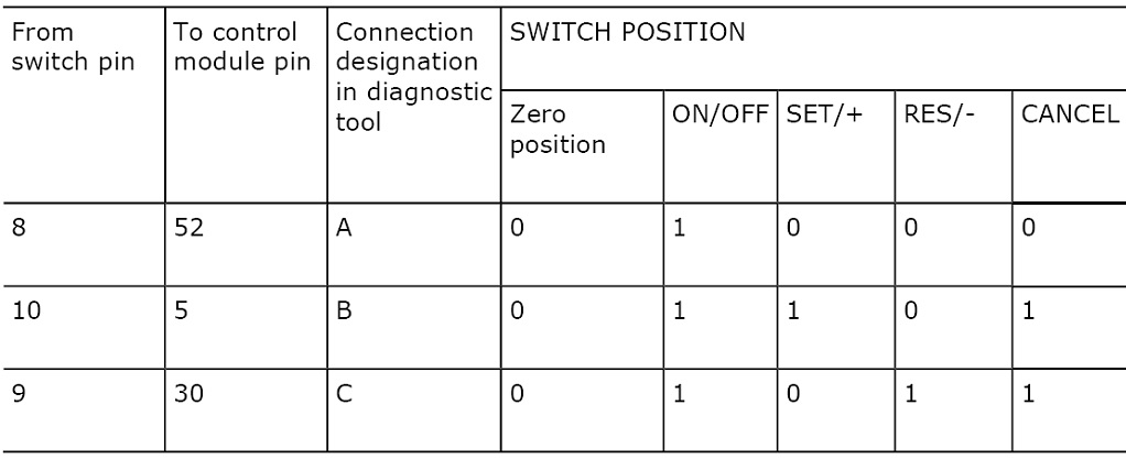

Switch Positions
Zero Position
The switch is spring-loaded to the neutral position. None of the switch connections A, B or C is live.
ON/OFF
When the switch is moved to the far left, connections A, B and C are supplied with current. The ON/OFF position has two functions, alternately ON and OFF.
CANCEL
Between the neutral position and ON/OFF, switch connections B and C are supplied with current. The position has the same function as pressing the brake or clutch pedal, i.e. the cruise control is disengaged but the set speed is retained in the memory.
RES/-
When the switch is moved to the far right from the neutral position, connection C is supplied with current. The position has three functions:
1. Engages the cruise control and stores the current speed in the memory if no speed has already been stored there.
2. Engages the cruise control if a speed is stored in the memory but the cruise control function has been disengaged with CANCEL, the brake pedal or the clutch pedal.
3. If the position is selected while the cruise control is active, the speed will be reduced. When the control returns to the neutral position, the current speed will be stored and the cruise control function continues.
If the position is selected in less than 300 ms, the requested speed will be reduced by 1.6 km/h (1 mph).
SET/+
At the end of the direction indicator stalk is a spring-loaded pushbutton. When this button is pressed in, current is supplied to connection B. The position has two functions:
1. Engages cruise control and stores the current speed in the memory regardless of whether another speed is already stored in the memory.
2. With the button pressed in, vehicle speed increases. When the button is released, the current speed is stored and the cruise control function continues.
If the button is pressed in for less than 300 ms, the requested speed will be increased by 1.6 km/h (1 mph).
The following conditions must be fulfilled for the cruise control to be activated:
1. Brake light switch = 0
2. Clutch and brake pedal switches = 0
3. Speed, lead from ABS >40 km/h.
4. Speed, bus from MIU >40 km/h.
5. Rapid speed reduction = 0.
6. TCS Not Active (Lead from TC/ABS).
7. - Manual gearbox: Gear ratio matches one of the gears.
- Automatic transmission: Selector lever in position D, 3, 2 or 1.
8. Brake light switch, clutch pedal switch and brake pedal switch simultaneously = 1 at some time during this drive cycle.
9. No diagnostic trouble code for throttle control blocking.
10. Inputs A, B and C = 0 before the switch is moved to ON/OFF.
11. Cruise control is activated by the switch.
When the brake pedal or clutch pedal is depressed, the pedal switches cut off the supply of current to control module pin 29 and cruise control is disengaged. On cars with automatic transmission, the circuit is supplied with current from the gear selector lever in positions D, 3, 2 and 1.
Brake light switch
When the brake pedal is depressed, the two normally open contacts on the brake light switch are closed and current is fed to control module pin 63.
The brake light information is used by the control module to enable:
• disengaging cruise control
• engine torque limitation when brake pedal depressed
• engine torque limitation when the automatic transmission stalls
• diagnosis of the speed signal.
Diagnostics
The diagnostic tool contains a menu which shows the conditions which have not been fulfilled if the cruise control cannot be activated. Another menu shows why the cruise control was disengaged when it was last used.

Cruise Control piduripedaali lülitiga (roheline pistik) on selline kihvt asi, et sellel saab hoova uuesti välja tömmata pikemaks kui piduri pedaal alla vajutatud on, ning siis lasta pedaal uuesti lahti ja ta reguleerib oma pikkuse kenasti vajalikult öigeks:
Kui asenduslüliti olin asemele pannud, siis piilusin vanale lülitile ka sisse. Klemmid (ei tohi sassi ajada, erinevate pikkustega) ajaga muidugit natukse kulunud ka, kuid pöhiline viga paistis oksiidikihis olevat, mis neile peale tekkinud oli. Puhastasin korralikult klemmid, määrisin taas libedaks ja panin kokku tagasi. Hetkeni toimib taas kenasti.

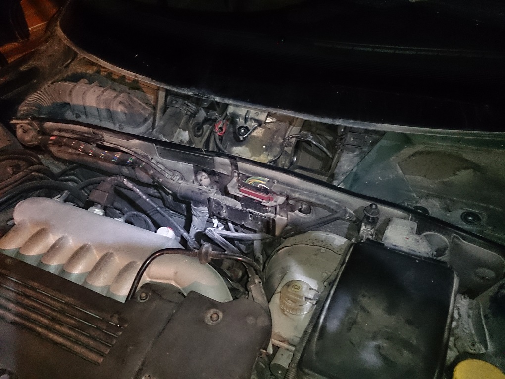

Esilaternate kojameestemootoritest tagasi pannes parempoolne korra töötas (ei jöudnud ära fikseerida, kas käis ka öigetpidi) ja siis löpetas taas tegevuse, tuleb uuesti lahti vötta ...

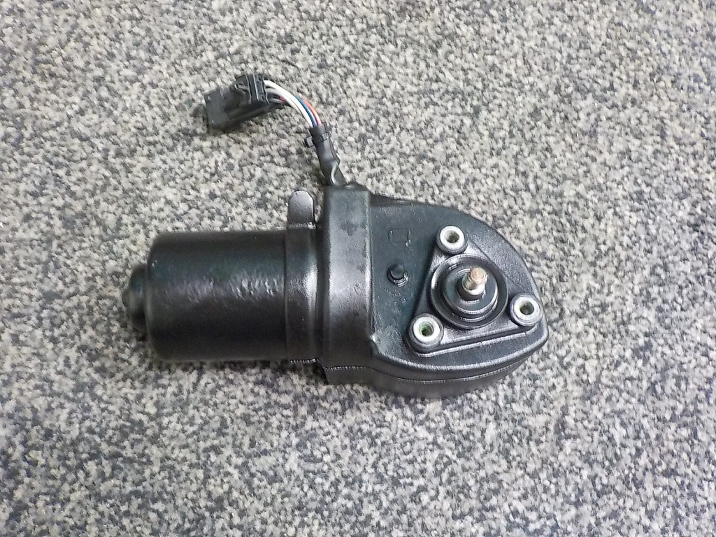

Mu on üks selline uus kojamehe mootor veel jäänud vanast ajast.
Muidu peaks nad olema tootmisest maas ja uuena osta enam ei ole võimalik
overspeed
Postitusi: 743
Asukoht: Saaremaa
Auto: 9-5 Estate ja 9-3 CV
#331
Mootori ma proovin korra veel lahti vötta ja uurida, miks ei toimind, voolud peale igatahes tulid. Kas jutt käib parempoolsest mootorist rohelise pistikuga ?
Kui asja ei saa, siis tuleb uus asemele osta, köik söltub ka muidugit hinnast. Vötan arvesse.

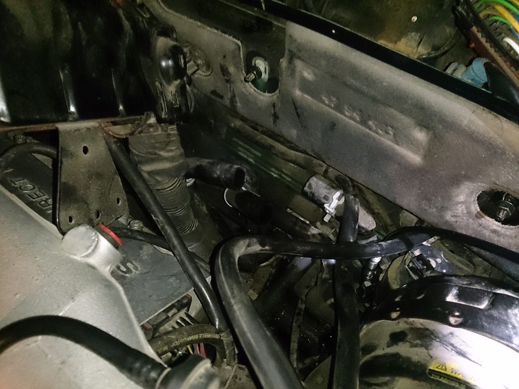

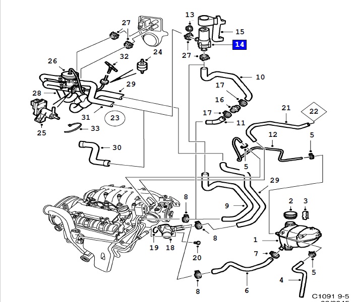

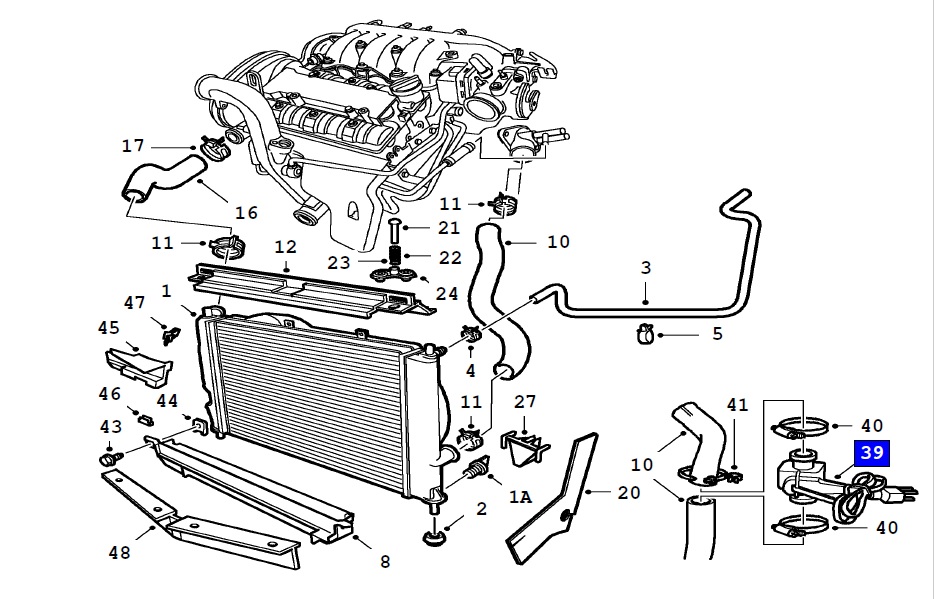

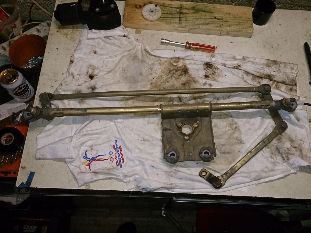

Sai pisut nokitsetud jahutusvedeliku By-Pass klapi, -tsirkulatsioonipumba ja kojameestehoovastiku (puhastus, kontroll, määrimine) kallal:
002 vedelikud.jpg (271.42 KiB) Vaadatud 16689 korda
003 wiper-01.jpg (292.01 KiB) Vaadatud 16689 korda
004 wiper-02.jpg (315.93 KiB) Vaadatud 16689 korda

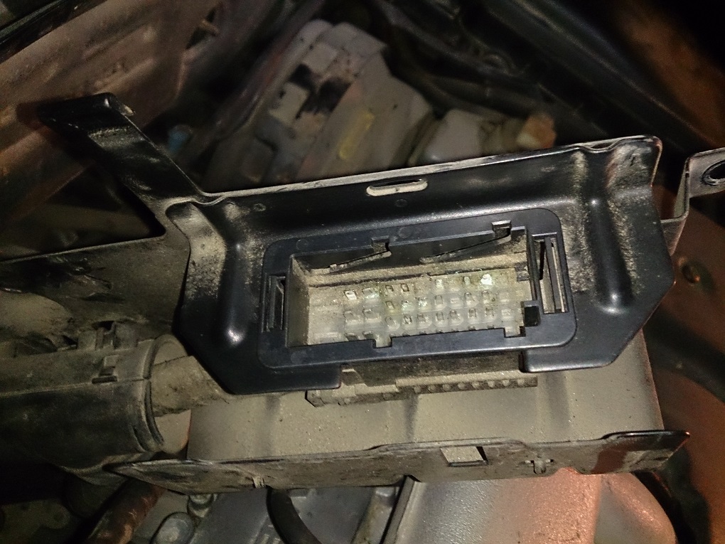

Ja tollel pistikul oli paar piid oksüdeerunud:
005 pistik01.jpg (249.35 KiB) Vaadatud 16689 korda
008 tsirk-pump-ja-bypass-klapp.jpg (114.55 KiB) Vaadatud 16689 korda

Imestama pani, kui kiiresti mootor ikka soojaks läheb. Sinine nii ei läinud, et kuda ikka saab. Lugesin pisut.
Lödviku vahel on elektrisoojendi jahutusvedelikule. Kui mootor on käima läinud, siis hakkab generaator voolu tootma ja oma geneka vooluga soojendatakse jahutusvedelik elektrisoojendiga kiiremini nominaali.
Väga brå ...
... aint et oma masina kapoti alt ma mitte sellist soojendit ei leidnud lödviku vahelt. Ju siis lihtsalt soojus-energia-rikas mootor :P

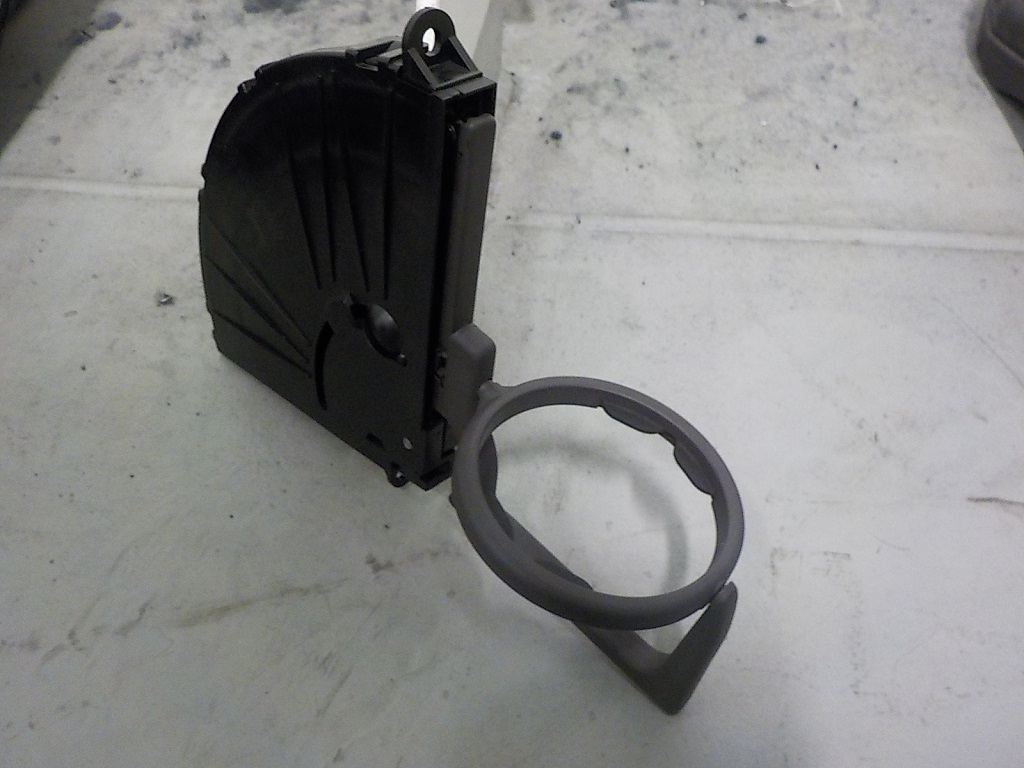

Dekonstrueerisin tolle DI kasseti, millel pragu sees oli. Poleks ka miskit hullu, kui pragu jäeks, kuid liimisin ta siiski kinni. Kummiosadele de-elektrilist pastat, vedrumetallidele elektrilist pastat.
Viimati muutis overspeed, L Dets 16, 2017 18:43, muudetud 1 kord kokku.

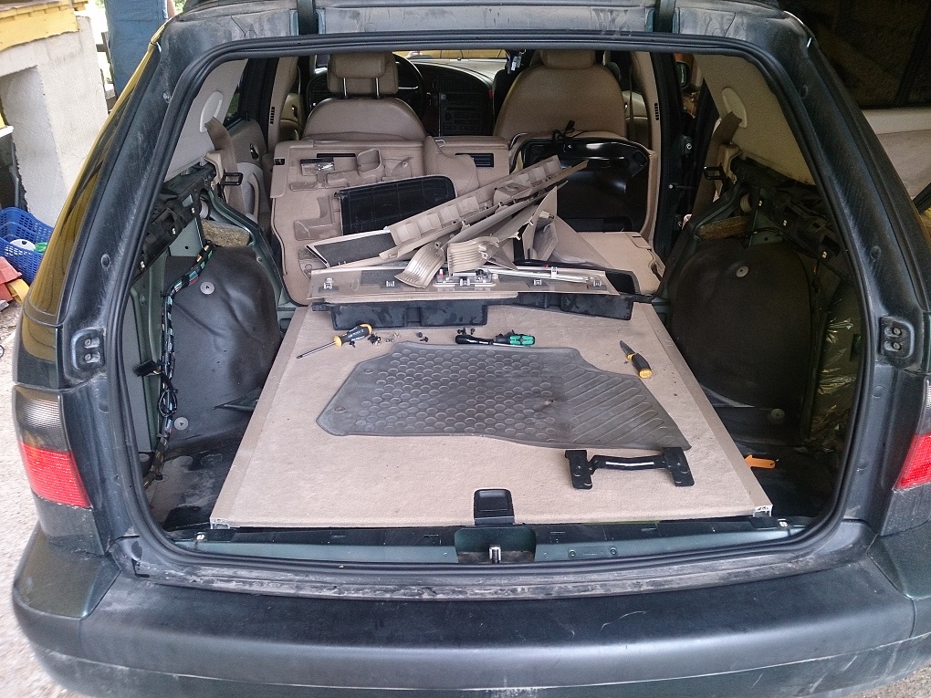

Tugevdan tagaluugi käepidet ... ja toimibki:
Millise paksusega plekki kasutasid? Monitori tald? On sellest kasu olnud? Ma arvan, et plekk peab olema jäik ja v. täpselt tehtud, tihedalt plastikule ümber istuma. Muidu pole tast kasu. Sa kinnitasid 2 punktist aga originaalis on 4 punkti - peale kruvide on veel plasttüüblid käepideme alumises servas. Need annavad esimesena järelle, käepide hakkab luugi sikutamisel väänduma ja edasi tekivad praod kruvipesade juurde.
overspeed
Postitusi: 743
Asukoht: Saaremaa
#335
Jutt jumala öige !
Pleki paksust peast enam ei mäleta. Kuid valisin suht paksu, mis veel kenasti luugi ja käepideme vahele mahtus ilma et käepide eemale punnitaks.
Kasu on ja toimib kenasti.
Plekk sai kenasti vormitud ümber töesti, pidin lausa kaks korda tegema, sest esimene ei tulnud ideaalselt ümber.
Plekk nii jäik ei ole, et üldse läbi ei painduks, kuid hoiab hästi ja ei murra plasti. Neljast punktist olen teadlik, need kaks tüüblit on jah kiired katki minema. Kuid neid asendada saaks vaid siis, kui plekile punktkeevitusena tüübliasendused külge keevitada, mingiks muuks lahenduseks seal ruumi ei ole uusi tüübleid panna. Ja ma ei tahtnud, et väljaspoolt miskit tugevdusümberehitust näha oleks (kui läbi plasti tüüblid panna).

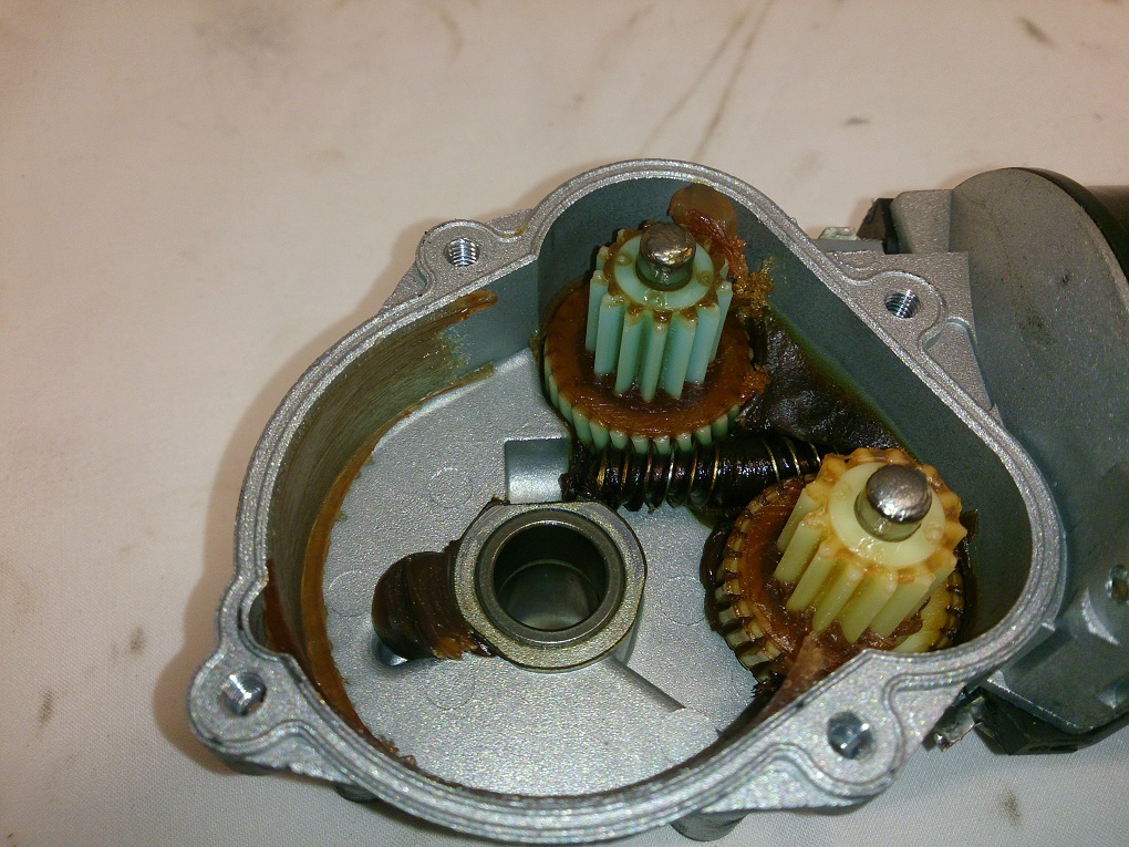

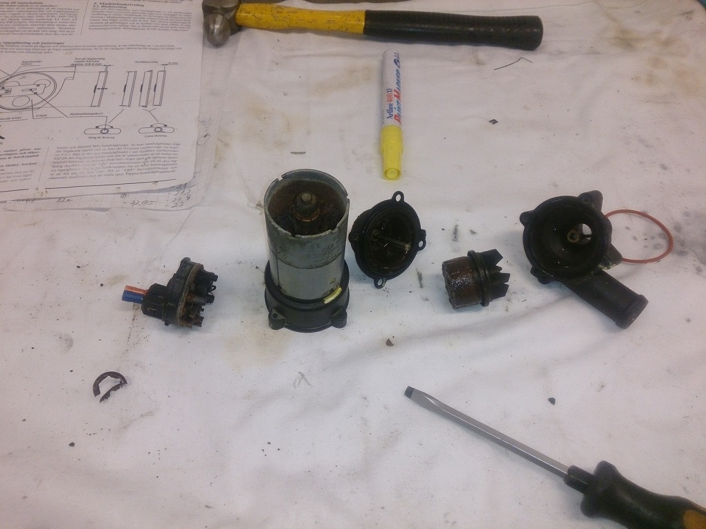

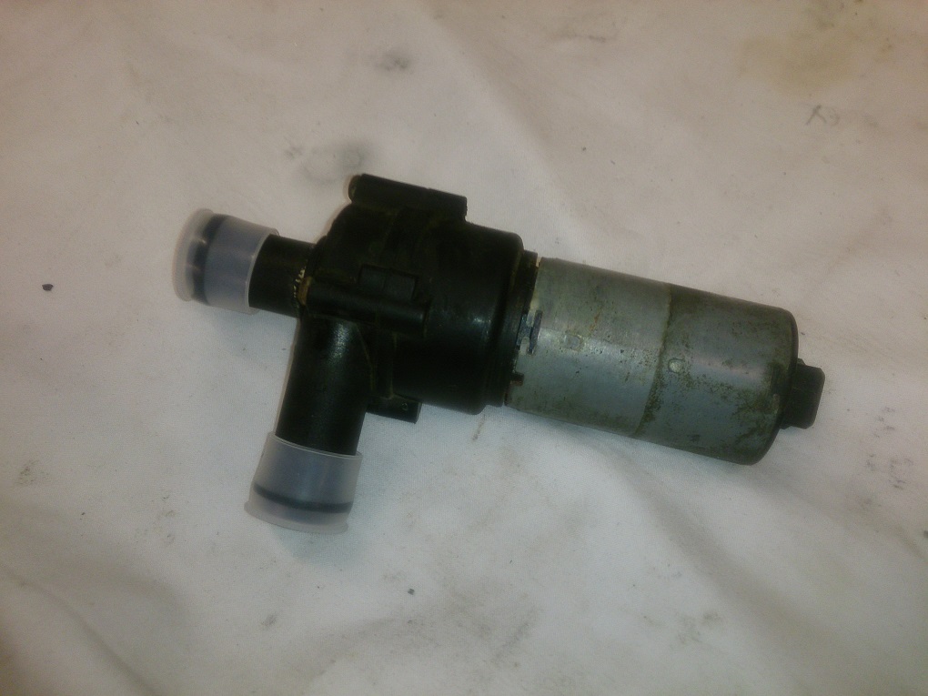

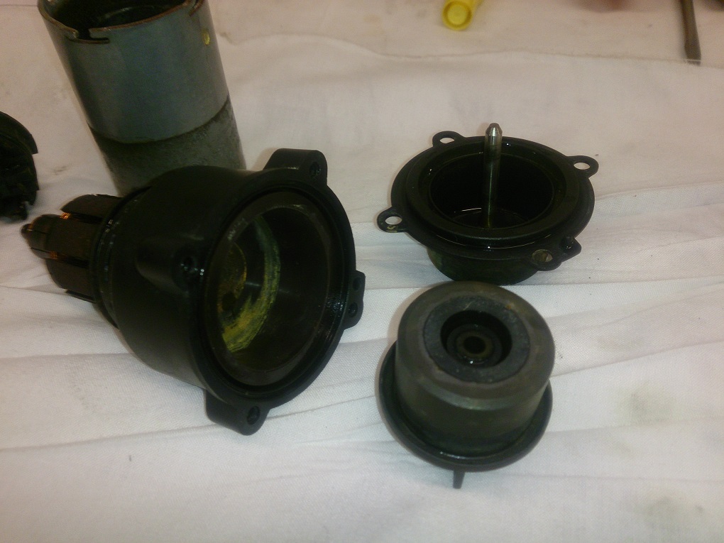

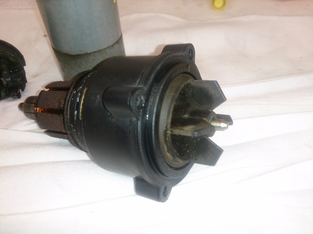

Jahutusvee tsirkulatsioonipump vahetatud, mötlesin et piiluks mis vanal sees on. Arvata vöib, et roostes ning seetöttu ka ei töödand.
Ja nii ongi, el mootor roostet täis. Korda teha ma teda aga ei saanudki, sest liugurpukside kinnihoidmisvedruseibid olidki need, mis puruks roostetanud olid, ja puksid olid völlil ikka VÄGA kinni, niiet alumist osa ei saanudki lahti vötta.
Huvi pakkus aga asjaolu, et pole varem kohanud seda tüüpi pumbaehitust. Pumba impeller ei ole otse el mootori völlil, vaid läbi magneti. Kaval värk.
Pilte ka, kui kellelgi huvi pakub:

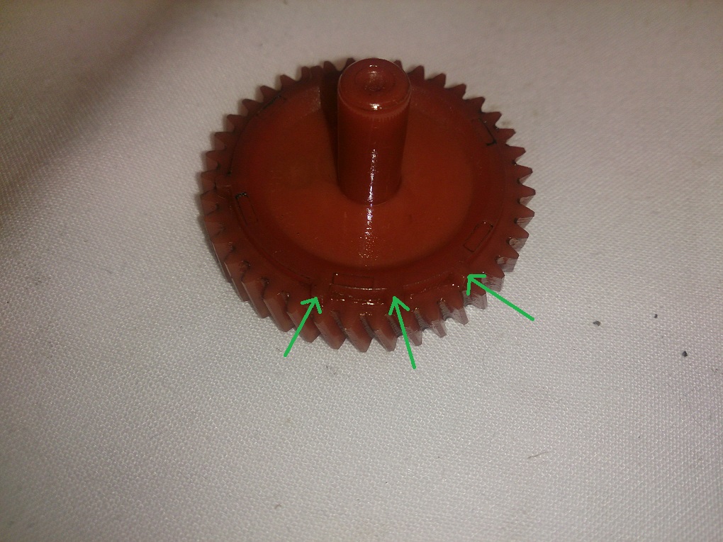

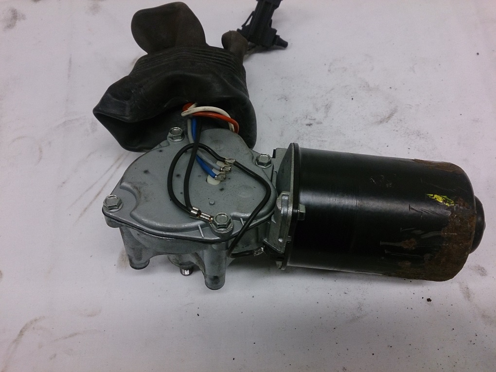

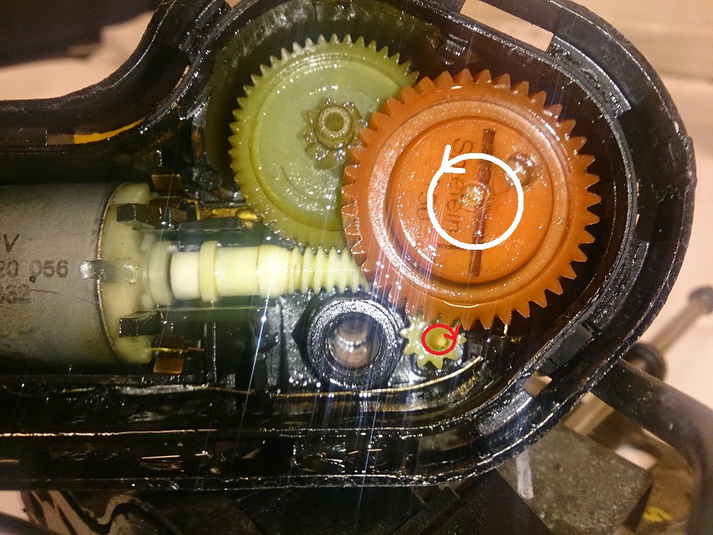

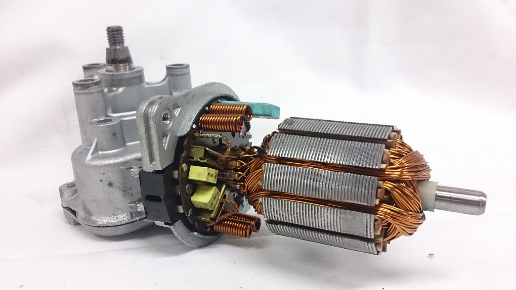

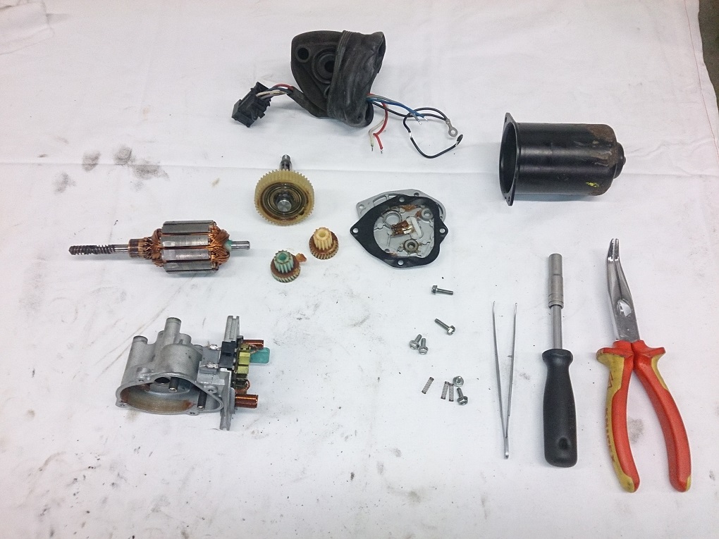

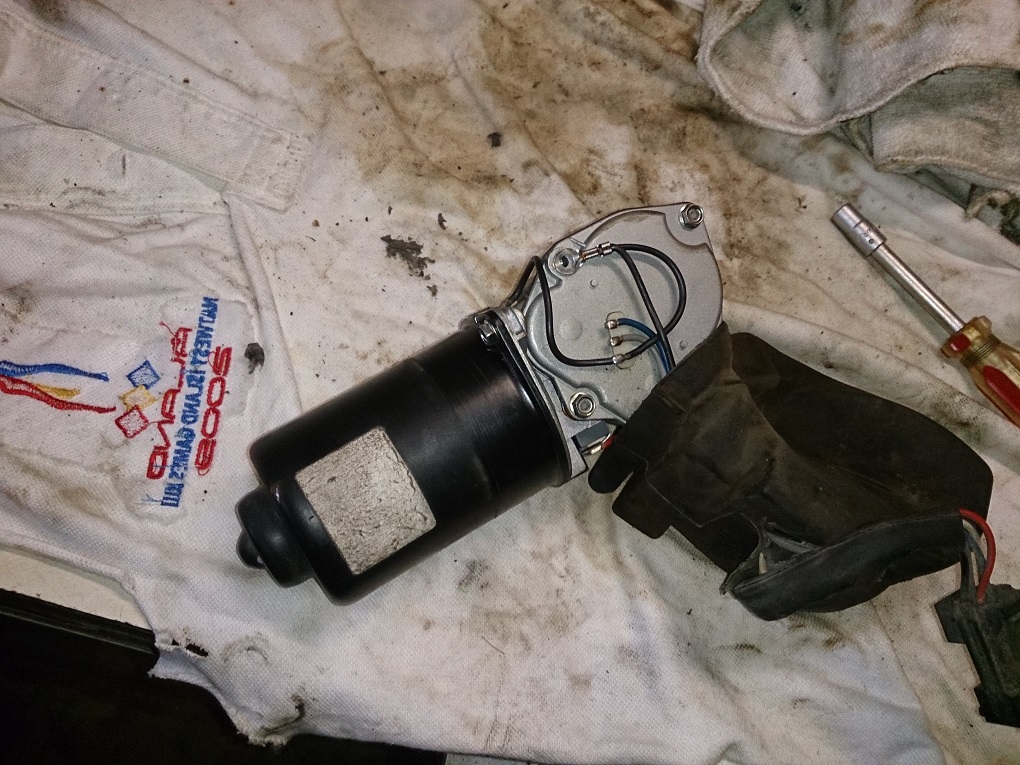

Sai üksjagu "ragistatud" nende kojameeste mootoritega.
Vötsin aga uuesti lahti.
Vea, miks parempoolne ei töödand, leidsin kohe. Tollel termokaitsel oli halb ühendus, sai pisut liialt öliga kokku.

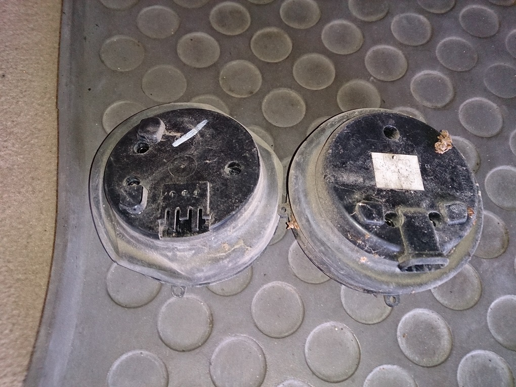

Vaatasin siis asja teise pilguga ja leidsin vastused. Roheline pistik on kundepoolne ja sellel käib punane hammakas tähega "R", hall pistik on juhipoolne ja sellel punane hammakas tähega "L". Samad vastavad tähed on ka mootori korpusel.
Pistikuid valesti ühendada auto külge ei saa.

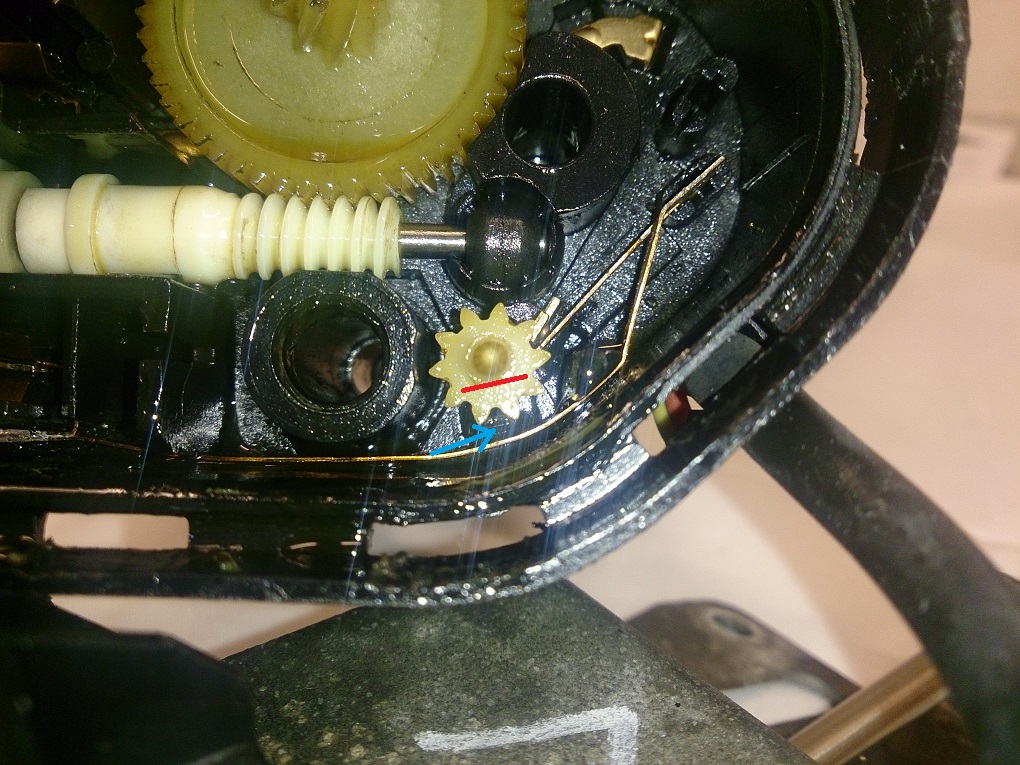

Kogu mehhanism töötab mölemal ühtselt ja sama pidi. Vahe on vaid punase hammaka hoova augus. Hammaka taga olevad katkesti naksid on samad, kuid seisma jäädes on surnud punktid hoovastikkudel erinevates äärtes. Nii ka ju loogiline, üks alustab käiku päripäeva, teine vastupäeva. Siis teevad kaks käiku ja jäävad uuesti seisma.
Olingi punased hammakad eelmisest korrast vahetusse eksklikult ajand. Panin nad öigetesse korpustesse ja toimivad mölemad kenasti ja öieti.
Nuputamist vajas veel aga see, kuidas panna hammakd sisse nii, et mootor seisma jäeks just surnud punktis, mitte nöks ennem seda. Niisama lampi hammakad sisse pannes ei leia ta omale öiget kohta ise ülesse.
Surnud punktides on tal ka üleviskamise leevenduseks too plastist "amortisaator", mille vastu metallhoob höörub.
Punane hammakas pöörleb (kaane poolt vaadates) vastupäeva, ja selle all olevad nukad liigutavad valget väikest kontaktikatkestushammakat päripäeva (nukad punasel hammakal on paigutatud nii, et kojamees jöuaks teha 2 edasi-tagasi käiku ennem kui valge hammakas katkestab vooluahela). Siis peab kojamehe hoob olema äärmises surnud punktis.
Vastust internetiavarustest ma ei leidnudki. Oli küll juhendeid, kuidas lahti vötta ja kust uusi mootoreid saada, kuid hammakate tagasipanemisest mitte midagi.
Nuputasin ja uurisin, äkisti on mingid märgid kuskil peal, ei leidnud.
Üks vöimalus on ju ka muidugit lasta mootoril valge hammakas kontaktikatkestuseni pöörelda, ja siis käsitsi punane hammakas paika tösta. Kuid selles asendis on hoob "amortisaatori" vastas ja suht pingeall tuleb kokku panna.
Tegin siis alljärgnevalt, ja tundub toimivat:
Valgel hammakal on pealpool üks völlikülg sile, selle panin tolle musta fiksaatoriga kohakuti. Nii on valge hammakas just väikse naksu puudu kontaktikatkestuskohast:
Punase hammaka panin (arvestades pöörlemise suunda) selliselt, et punasel hammakal kolm körvuti olevat valget hammakat liigutavat naksu asetseksid just ennem valge hammakaga kokkupuutumist.
Nii ei olnud hoovastik ka surnud punktides ja plast"amortisaatori" sai kergelt külge.
Siis panin kaane tagasi ja lasin (andes + voolu punasele juhtmele) mootoril leida ülesse katkestuskoha. Kollasele juhtmele voolu andes lasin mootoril taas minna uude tsüklisse ja siis uuesti vool punasele juhtmele ja kontrollisin kus ta seisma jääb. Toimib öieti. Kontrolliks vötsin ka surnud punktis uuesti kaane maha ja vaatasin visuaalselt üle, kas punane hammakas on ikka öiges kohas, jah on.
Ja nii toimis mölema mootori puhul.

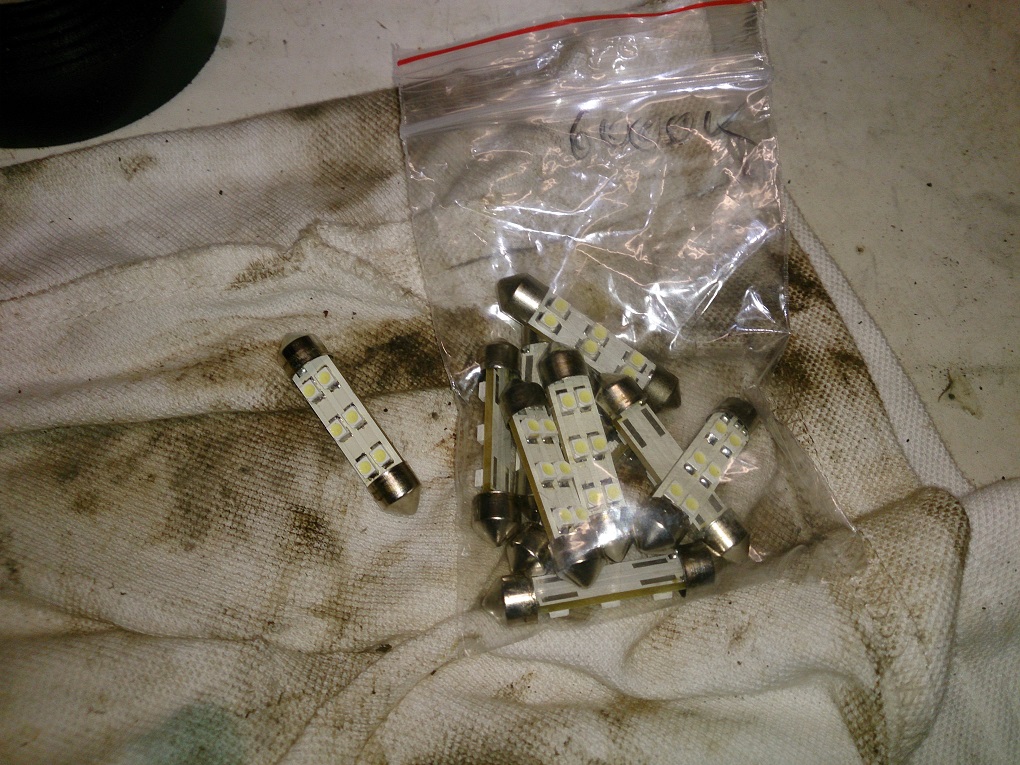

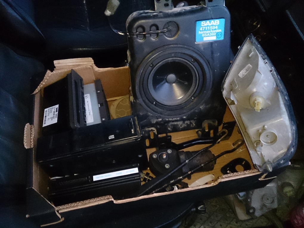

Esilaternate kojamehed töötavad nüüd mölemad enamvähem kenasti ja sai ka nendele tellitud uued luuad.
Muretsesin pisut varuosasid autole:

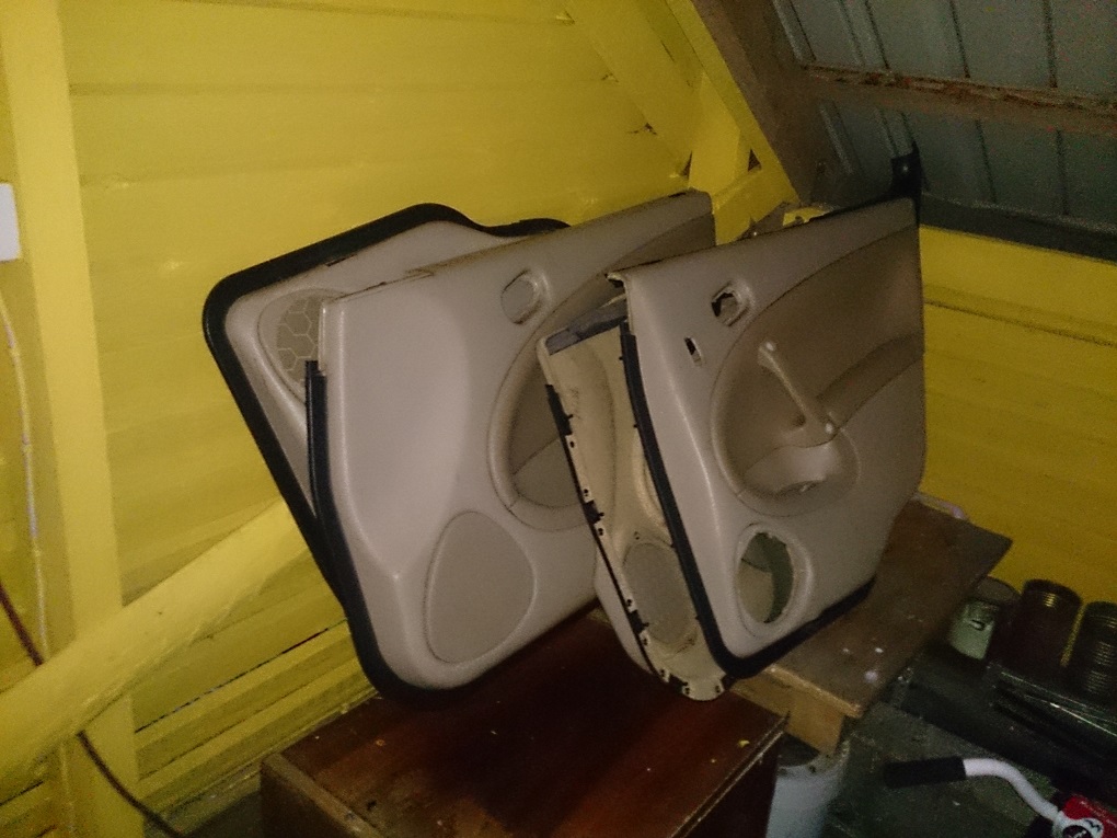

Ustepolstrid vahetan seetöttu, et riide asemele tahan nahast/siledaid pindasid:
Salongi- ja ustealuse-valgustuse pirnid (12 tk) vahetasin köik led-pirnide vastu. Nüüd ei pea muretsema aku pärast, kui uksed pidevalt lahti on, ja seda nad tihti kodo on:

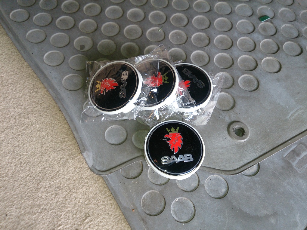

Kulunud Saabi siniste märkide asemele otsustasin panna musta värvi märgid:
Ja samuti mustad velgedele, et paremini sobiks:
Ja vahetust ootavad ülemine SID (tuleb remontida, kuna taustvalgus ei pöle ja piksleid on palju puudu), esimene topsihoidja (uus ootab paigaldust) ning makk (ei vöta plaati sisse). Kuid ennem pean uurima, ega mul peal olev makk "married" autoga pole, kindlam vist on kui "divorce" oleks ja siis saab sellega hiljem ka miskit teha.

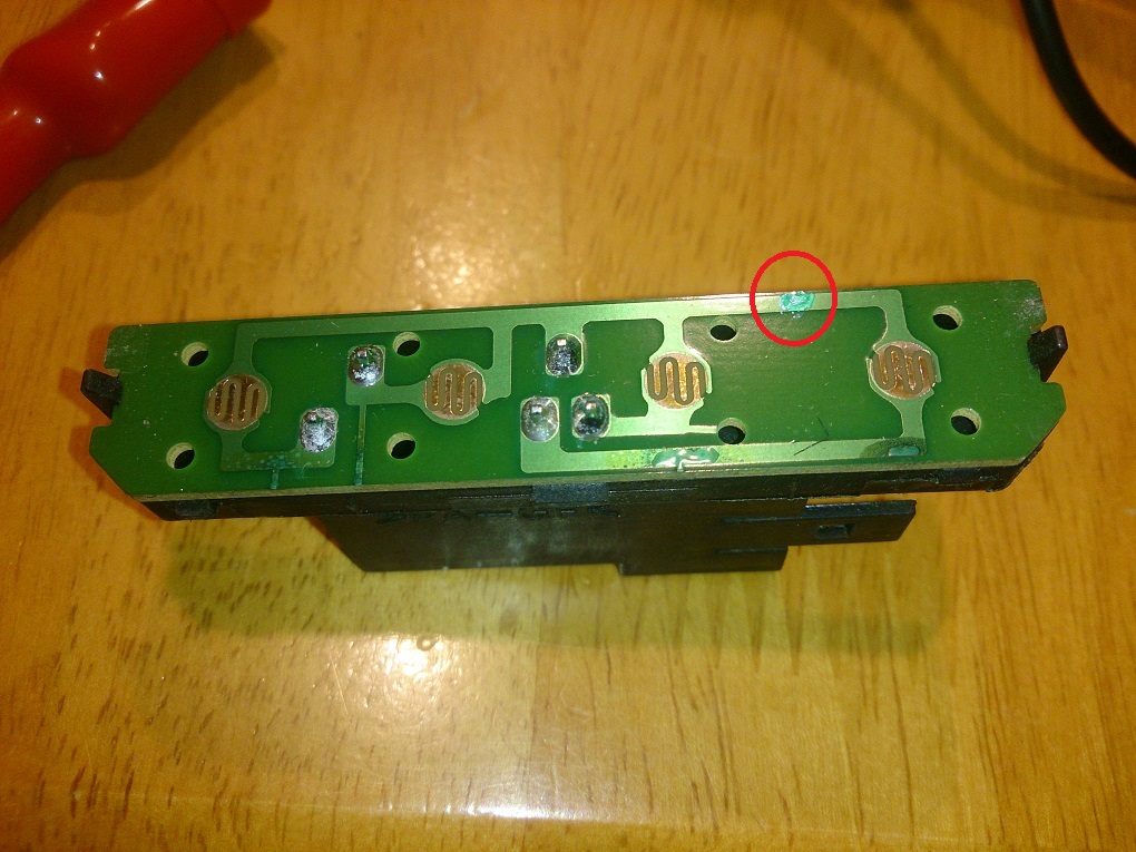

Kodus vötsin maha istmemälude lülitid. Leidsin, miks mällusalvestusnupp ei tööta. Sellel elektroonikaplaadil on tolle nupu siin läbi oksideerunud. Jootsin juhtme peale ning töötab taas, saab jälle uusi asendeid mällu salvestada :)

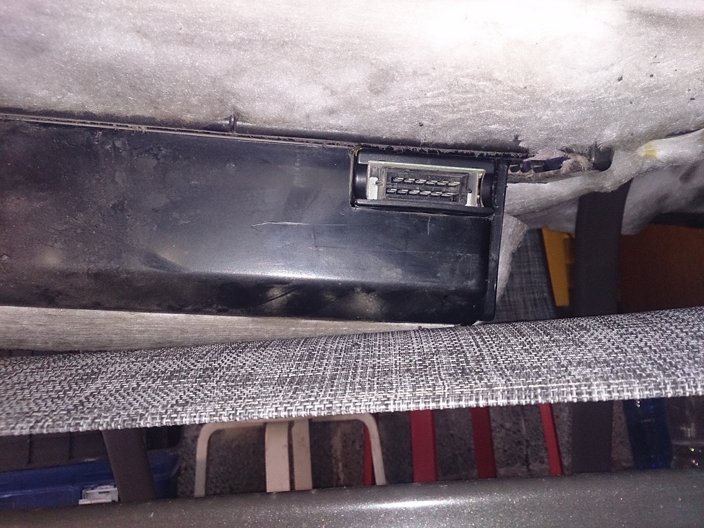

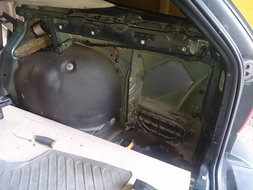

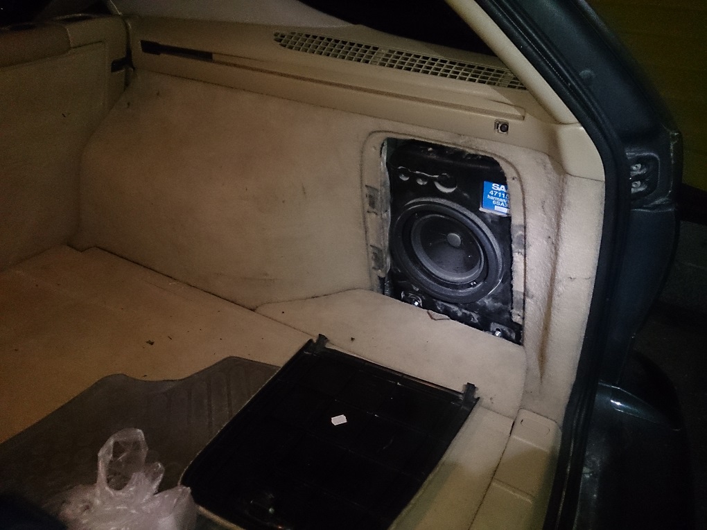

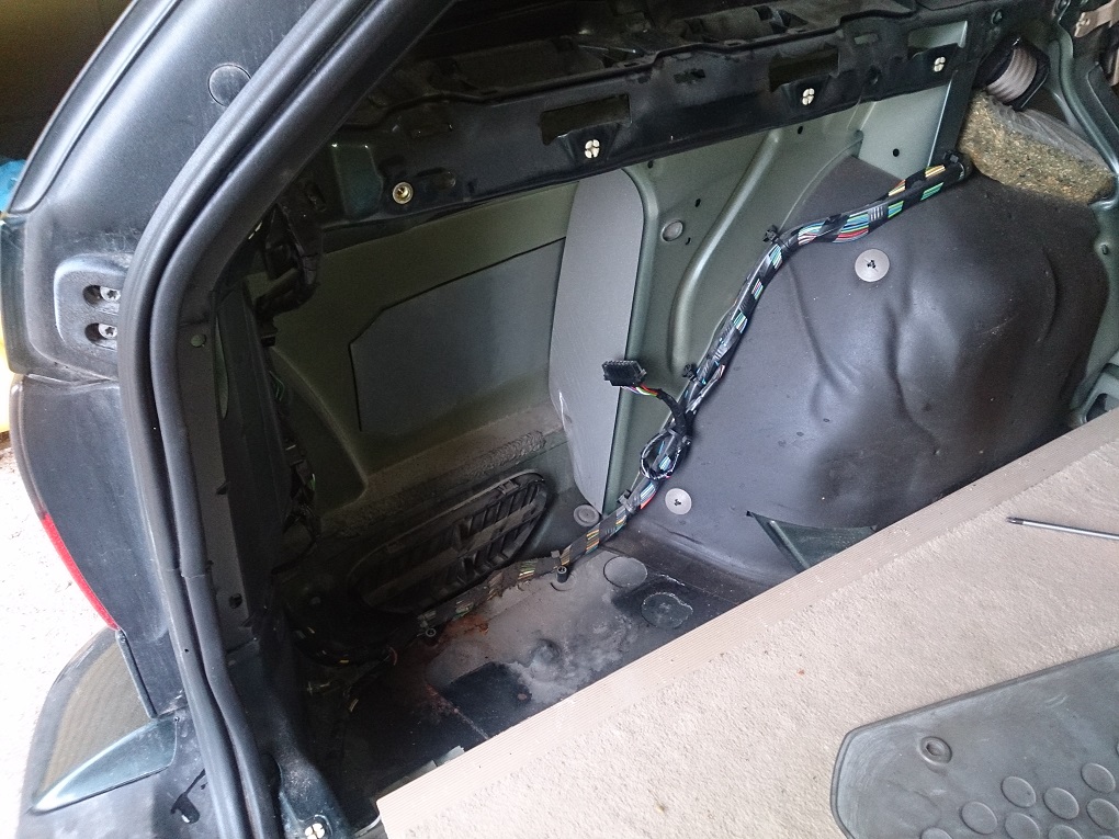

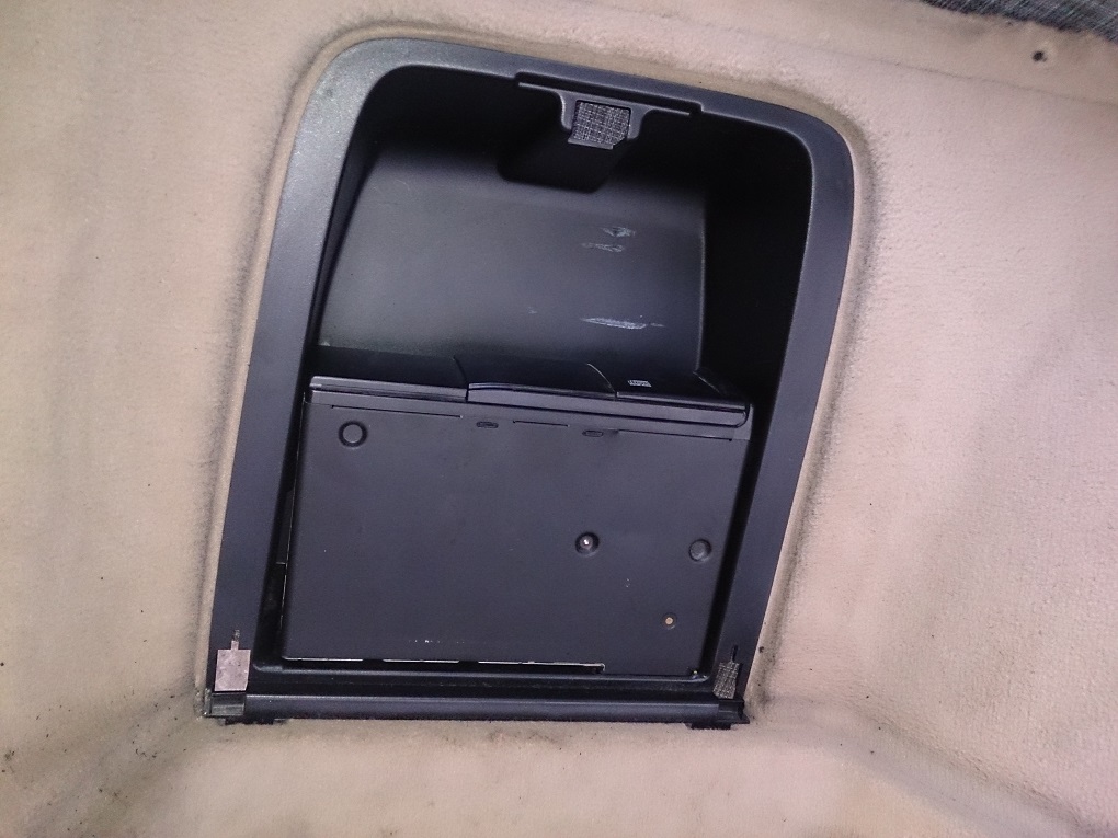

Lammutasin pagassilt polstrid, et uurida CD-changer ja pagassi-kölari paigaldusvöimalusi. CD-boxi pistik olemas, kuid pagassi-kölari kaabel puudub :(
Tuleb uurida juhtmete skeeme ja ise vedada.
Speaker-luggage-comp.-to-remove.-to-fit.pdf
(131.09 KiB) Allalaaditud 6091 korda
CD-changer.-to-remove.-to-fit.pdf
(113.11 KiB) Allalaaditud 6071 korda
Radio-Main-Unit.-to-remove.-to-fit.pdf
(39.37 KiB) Allalaaditud 6096 korda

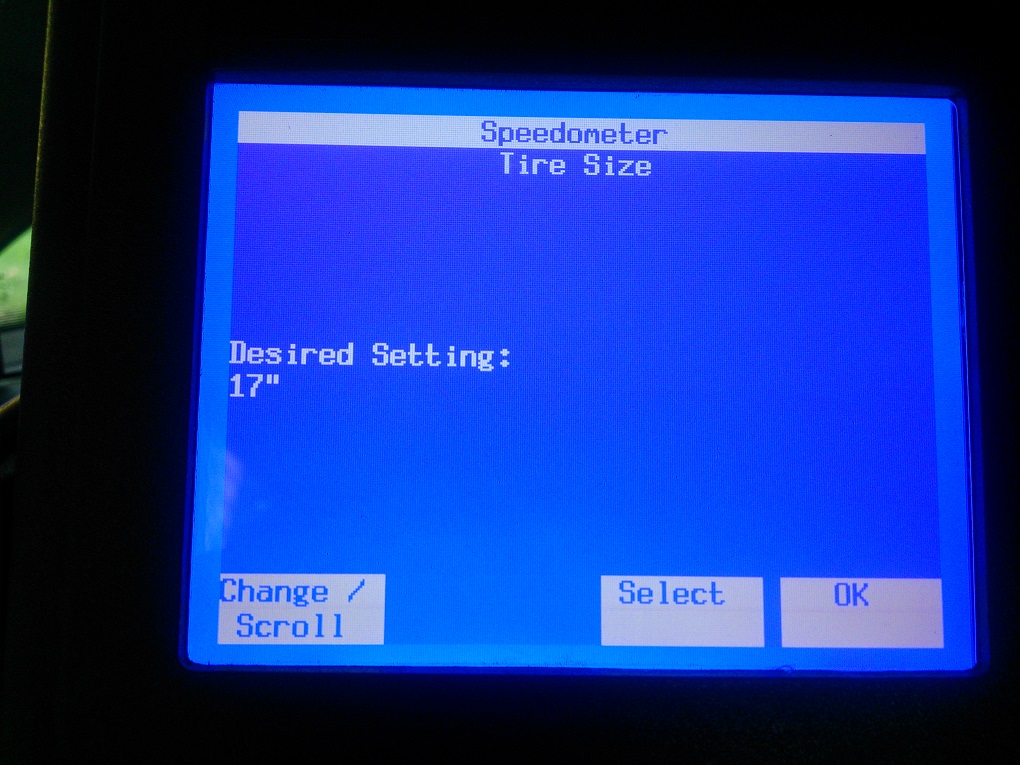

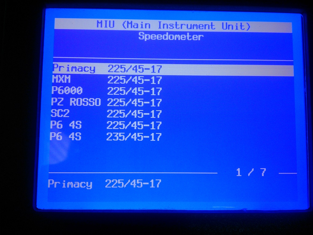

Sobrasin veel selle Tech2-ga ringi, ja vist leidsin, miks mo spidomeeter valetab (seal vist oli reguleerimise vöimalus ka kuskil, kuid seda ma näppima ei hakanud).
Mul oli autole öeldud, et all on 15'' rehvid (valikus oli 15'' ... 18''). Ütlesin talle, mis möödus rehvid on, ehk nüüd ei valeta enam niipalju.

Kas on vöimalik lukustatud makki lahti saada teades eelmise auto VIN koodi, ... ?
JAH nii saab teha küll.
Nii maki kui CD-box'i lahtitegemieks (mölemad näitasid Locked) sisestasin Tech2-te doonorauto andmed: aasta, mudel ja VIN kood. Siis lahutasin (Divorce) maki ja cd-boxi.
Siis sisestasin Tech2-te taas oma auto andmed (aasta, mudel ja VIN) ning sidusin (Married) maki ja cd-box'i.
Toimivad nüüd mölemad.
CD-boxi jaoks oli pistik polstri all kenasti olemas. Tuli vaid pistiku jaoks auk saagida ning kinnitus/fikseerimis poltide jaoks külgedele augud puurida:
Pagassi kölari jaoks juhtmeid tehase poolt ei leidnudki, pean need ise vedama. Paika panin kölari sellegipoolest, kui polster juba maas oli.
Kölari kate mul puudub, selle ehitan millestki ise.

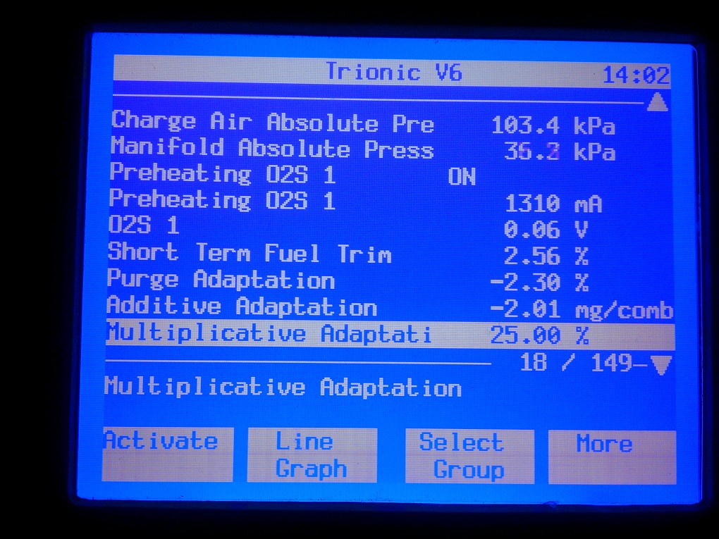

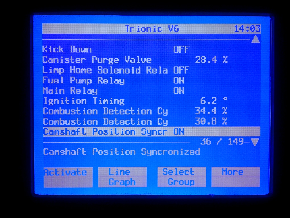

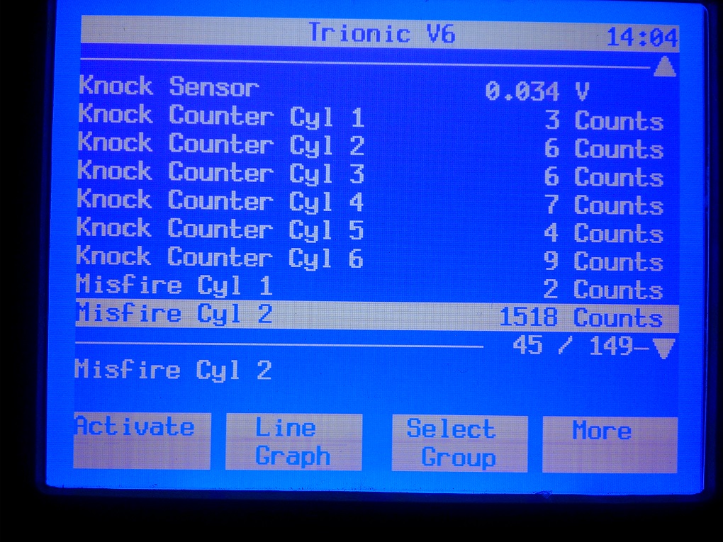

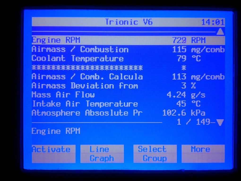

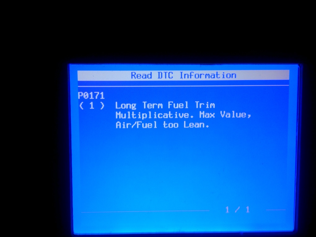

Check Engine tuluke süttis.
Pistsin Tech2 külge ja uurisin pöhjust.
P0171, lahja kütuse segu.
Vigu vöib olla mitmeid: Mass Air Flow andur must vöi valetab, öhuleke sisselaskekollektoris (gaasitrossi pingutades leidsin palju vaakumvoolikuid, mis vanad ja repetanud kohati, vahetasin need. Samuti oli åks pime kork throttle body'l ää tulnud, kuid köige selle juures polnud alarmi), auk väljalaskesüsteemis ennem lambdat, lambda ise (245'000 km on ka söitnud masin juba, lambdad vast sellises eas surema hakkavad).
Vaatasin muid andmeid ka. Ühel pangal on liialt palju Misfire lugemisi. Pölemata kütuse-segu vöib ka pöhjustada arvutile arusaama, et segu lahja on (kåttesegus olnud öhk ju jääb ka pölemata ja lambda loeb selle ålesse, arvates siis et segu lahja, kuna liialt palju öhku väljalaskes).
Viimati muutis overspeed, L Dets 16, 2017 19:09, muudetud 1 kord kokku.

Postitusi: 14527
#345
Kas see ühe di suremist ei või tähendada?
overspeed
Postitusi: 743
Asukoht: Saaremaa
#346
Seda kahtlustan jah, kuna sil 2 4 6 on ühisel pangal, eespoolne vist?
Mootor töötab veel kenasti. Kas viga vöiks ka olla äkisti DI-kasseti pistiku halvas ühenduses ?
Viimati muutis overspeed, L Dets 16, 2017 19:02, muudetud 1 kord kokku.
Arrogance diminishes wisdom !
Postitusi: 14527
#347
DI-d on vist ühesugused? Vahet omavahel ära, vaata, kas läheb viga teisele poole. Siis on suht kindel, et DI segast peksab.
overspeed
Postitusi: 743
Asukoht: Saaremaa
#348
DI-d on identsed (DI - Direct Ignition module, ID - Ignition Discharge module, COP-I Coil On Plug Ignition). Proovin sedasi.
Otsisin manualist, et kus milline number silinder asub, ei leidnudki otsest loendust. Läheb mul see V mootoritega alti meelest, sest laevades on järjestus teistpidi kui maapeal automootoritel.
Leidsin, et pank-1 on tagumine ja pank-2 on eesmine (arvata vöib, et siis eesmine-tagumine auto söidusuuna/nina suhtes ja silinder 1 peaks nagu asuma pank-1 peal (tagumisel)).
Kuidas üle kontrollida:
Turbo on silindritel 2 4 6, seda kirjutab manual.
Vaatasin siis varuosade kataloogist, et kummal pool turbo on (kapotialla vaadates ei paista turbo väljagi. Ühe korra olen roomand auto alla ja siis nägin vilksamisi turbot). Paistab, et eespoolsele pangale on turbo, seega need on 2 4 6. (hiljem piilusin kapoti alla ja kontrollisin teooriat, tööjuures ju autot tüki aega ei näe).
Exhaust manifold V6.pdf
(121.43 KiB) Allalaaditud 6045 korda
exhaust system V6.pdf
(93.39 KiB) Allalaaditud 6101 korda
V6 turbo explained.pdf
(34.39 KiB) Allalaaditud 6342 korda

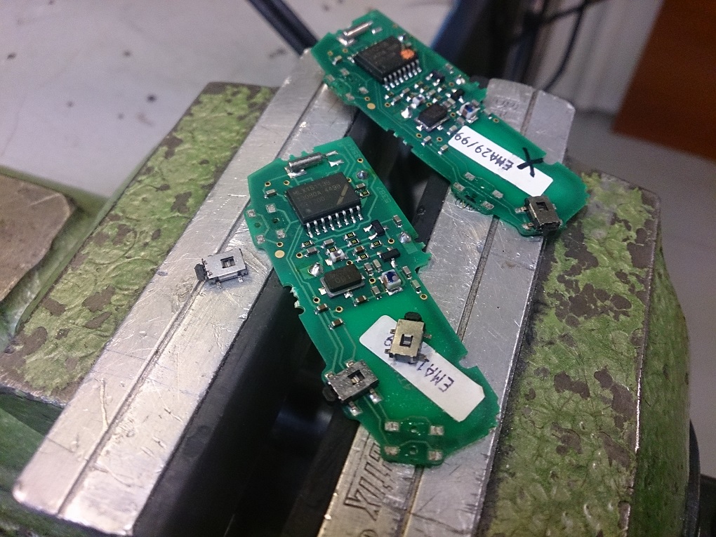

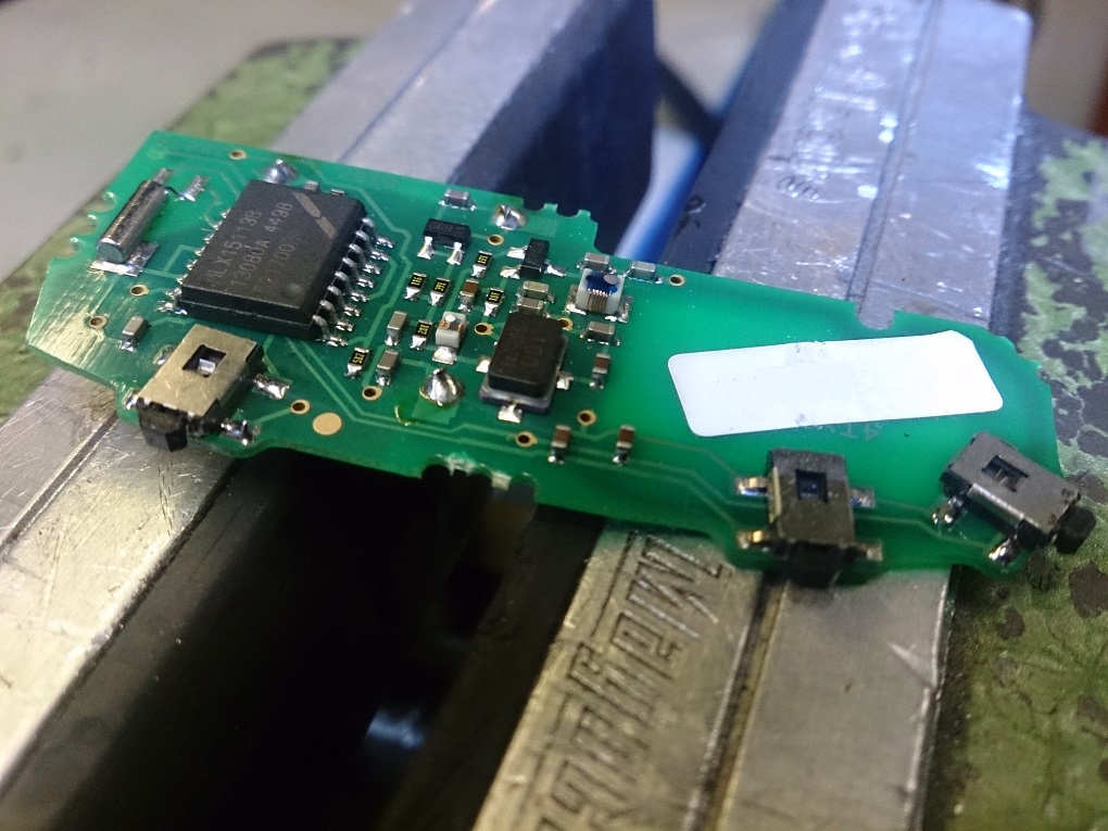

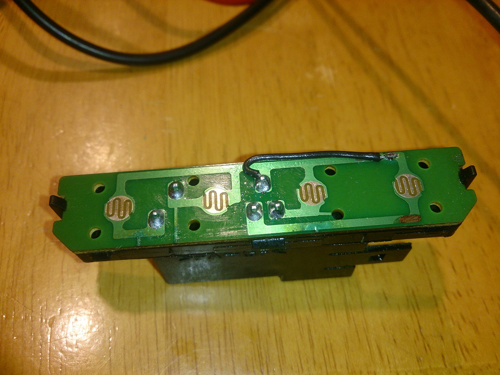

Kuna ma uut süütevötit, pult pea sees, Vikingist ei saand, otsustasin ka teise puldi kasutuskölblikuks teha.
Ostsin ühe suvalise kasutatud puldi ning jootsin sellelt enda puldi külge puuduolevad mikrolülitid. Nüüd kaks komplekti kenasti korras :)
Viimati muutis overspeed, T Dets 19, 2017 15:24, muudetud 1 kord kokku.

Praktselt enamus detailid, mis autol vahetan, olen ennem asemele ostnud, et auto ei jääks seisma puuduva detaili pärast, kui detaili hooldan/proovin remontida/ vöi siis katki ja alles hakkan siis uut otsima. Möni üksik asi on vaid selline, mida siis julgen maha vötta ning uurida, kas saab korda vöi peab uue muretsema.
Seega on neid varuasju nüüd üksjagu kogunenud. Uudishimust ja soov, et tagavaraks oleks taas korras asi, vötan vahetatud asjad ka üks-haaval lahti. Tööjuures auto enda kallal niikuitnii nokitseda ei saa, siis sisustan oma vaba aja detailide hooldusega.
Siin möned näited:

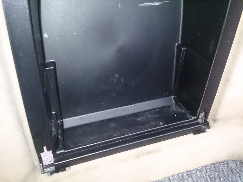

- esimese topsihoidja sain korda. Eelmine omanik oli sinna arvatavasti pölvega vasta läinud. Plekiraamistik oli nöksa köver ning otsast oli tulnud (mitte murdunud) too mummudega rist, mis topsiringi löpus horisontaali keerab. Too T-pöörel oli otsastkukkudes kiilunud mehhanismi vahele ja seetöttu topsihoidja enam üldse lahti ei tulnudki.
Painutasin plekkraami sirgeks, panin T-pööreli omale kohale tagasi ja toimib taas:
- Kojameeste mootoril otseselt viga midagi ei olnud. Lihtsalt vötsin lahti, kontrollisin, puhastasin, määrisin. Elektrimootori korpus väljast vajas aint natukse värvimist. Kummikate sai silikooniga kokku tehtud.
