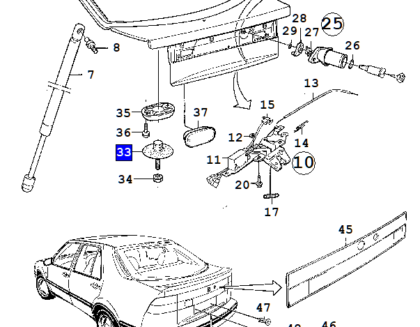

Kuidas reguleerida 9000 luukpära tagaluuki? Mul ei taha enam kuidagi esimese korraga kinni jääda, vaja ikka eriti pauguga lüüa või eraldi peale suruda. Kujutaksin ette, et regullida saaks nende kummipuhvritega, aga no keskmist jõudu rakendades (enne libisesid sõrmed üle, kui keerama hakkaks) ei liikunud kuhugi. Kas on mingi muu meetod või vaja siiski wd40 ja tangidega nende kummipunnide kallale minna ja riskida nende kahjustamisega?
Kood: Vali kõik
Adjusting the boot lid forwards and backwards
Adjust the boot lid backwards or forwards by loosening the nuts and sliding the lid in the desired direction.
Adjusting the height of the entire boot lid
Adjust the height of the boot lid by loosening the screws holding the hinges to the body and moving the hinges up or down.
Adjusting the front of the boot lid
1. Loosen the front two screws on the hinges.
2. Loosen the rear retaining screw just enough to allow the front of the hinge to be adjusted upwards or downwards.
3. Then tighten the front screw and check fit and function.
4. Tighten the remaining screws.
The position of the rear of the boot lid when it is closed is determined by the two rubber buffers mounted on it.
[b]1. Adjust the buffers by screwing them in or out.[/b]
saabu14jr
Postitusi: 1255
Liitunud: P Apr 22, 2007 9:48
Kummipunnidel kruti alt mutter lahti, siis saad neid regullima hakata. Kere küljes olevat vastust saad ka regullida kui plasti eemaldad.
