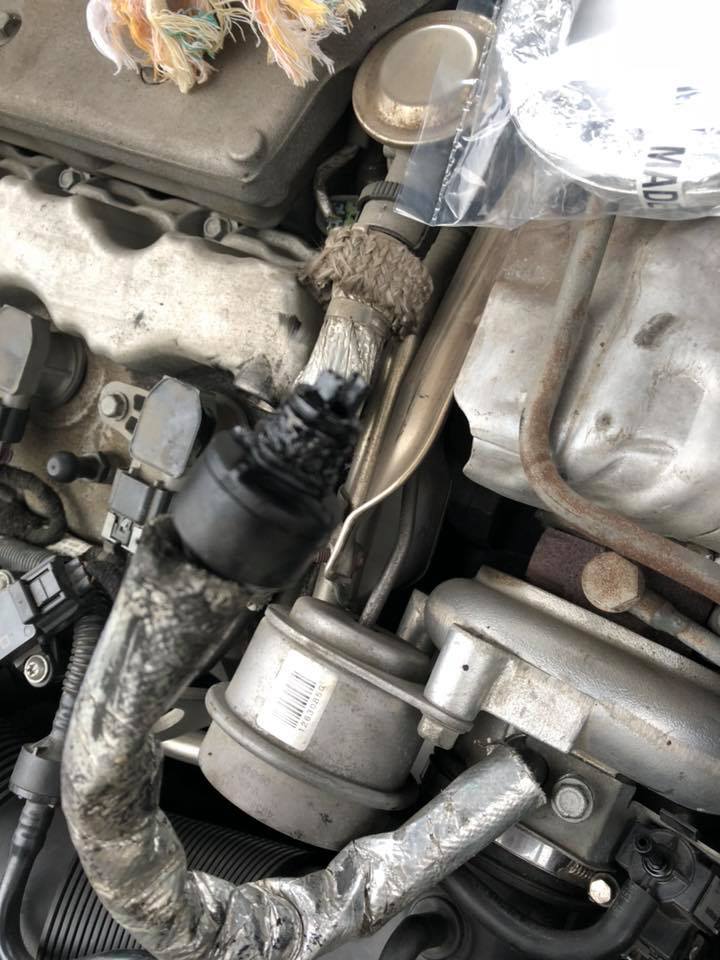

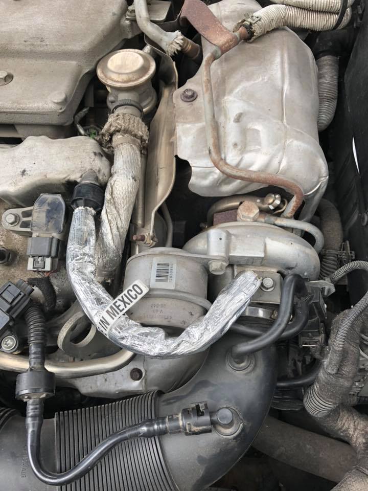

Replaced the PVC today, as the old one was hanging out of the crankcase cover. No idea when that got broken, but there is a one way valve in there so not sure if this was causing a vac leak or not. On comparison of the two parts the clips which hold the pipe into the cover were snapped off.
